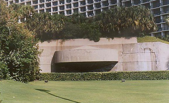

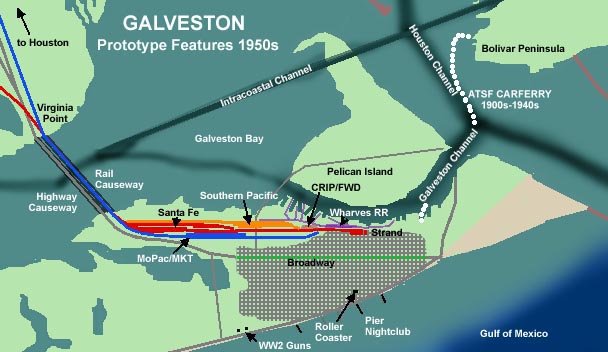

My layout is set in 1957, when this gun emplacement in Galveston TX was not operational, but it was still there as a relic.
Still is there. Not on the layout, but I have a spot set aside across the street from the beach. In real life, it was not near the railroad, but I am putting my big guns, the pier nightlub and the roller coaster near the rail causeway to the mainland…as if that was where the island ended on the west, and a clear “shot” to the Gulf.
