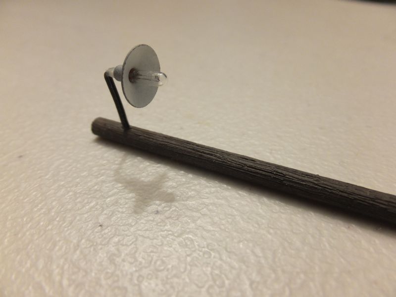

You’re very welcome, Dave. Here’s a pic of a single pole I scratchbuilt a couple of years ago.
I really like how well the razor saw technique works for creating the grooves in the styrene to simulate a weathered pole.
Granted the 1.7mm incandescent bulbs are a bit oversized. The 1.2mm look better and more realisitc but I could never get a consistent diffused beam with bulbs that small. Some bulbs were fine; others cast the light in a concentrated crescent shape.
Maybe those warm SMT LEDs would work better in this situation. At least with the incandescents you can dial down the voltage (e.g. 50%-55% max.) so that they will last longer.
Tom:
Thanks for the close up shot. The scored styrene does indeed look very realistic.
Dave
