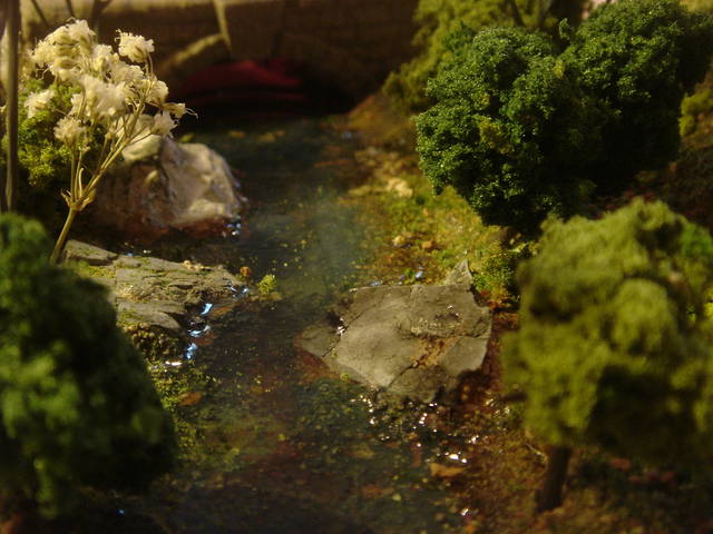

You might also check to see how David Popp made a river section on a corner of the Virginian Project layout, described in the 2012 articles or the videos on the MR site. I have a similar spot provided on a corner of my layout but have not decided how to do it.

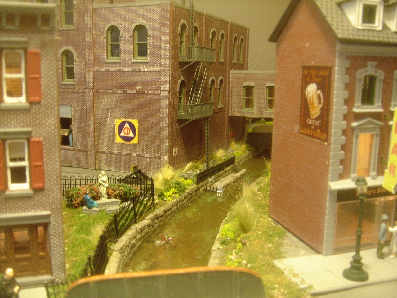

Limited experince for me but very happy with Envirotex. Simple to use, plenty of working time then cures very quickly, multiple pours are fine, its easy to tint with cheap acrylic paint. And the surface that results is hard, durable, and easy to clean.
I found that multiple pours are actually a big benefit. With the first pour you can confirm how level the area is and get a very good idea of where the water edges will end up. Then make adjustments to landscaping to dress up the banks so that the water meets the edge correctly before doing the next pour(s). It does not sound like this is possible with the pellets.
Two more advantages of multiple thin pours -
The tinting applied to each level of this swamp was different. At the lowest level, I used dark paint, and quite a bit of it, leading to a dark, murky bottom. The middle levels got lighter, and the top level was clear. This gave me the appearance of a swamp getting murkier as you look down into it.
The “waterline beaver” swimming in the middle was done by removing the legs, filing the base flat and using just a dab of glue to hold it in place as the final thin pour was done around it.
