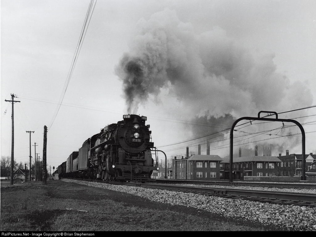

Here is NKP 2-8-4 771 pickin’ ‘em up and layin’ 'em down. You can tell it is really moving by the fact that there is a very long exhaust plume behind the stack that is still intact - living up to the slogan “High Speed Service”…

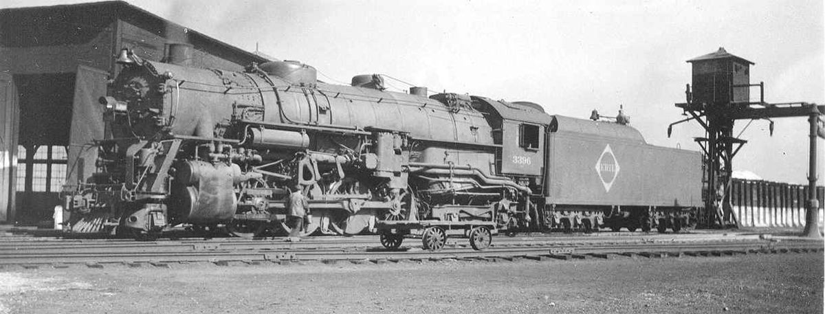

Anyway, no-one called them the “Weary Erie” anymore after those Berks showed up on the property!
And guys like RME and myself, both Jersey boys, lament the fact we came along just a little too late to see them in action.
We were a little too late for those oh-so-classy Russian Iron boilered Erie K1 Pacifics too, but that’s another story.
Big iron…

Rolling thunder!!!
kgb, thanks for those Erie shots, especially the one with “World Famous” HX Draw over the Hackensack River.
And LensCap, thanks for that video link! Just unbelieveable! And THAT was an everyday occurrance for Nickle Plate steam back in the old days!
My idea of “High Speed Rail!”
