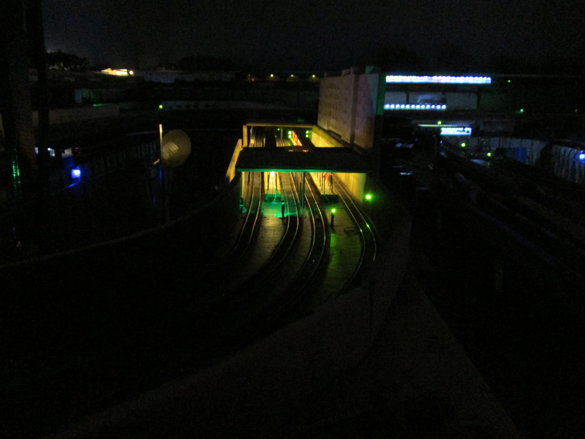

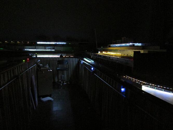

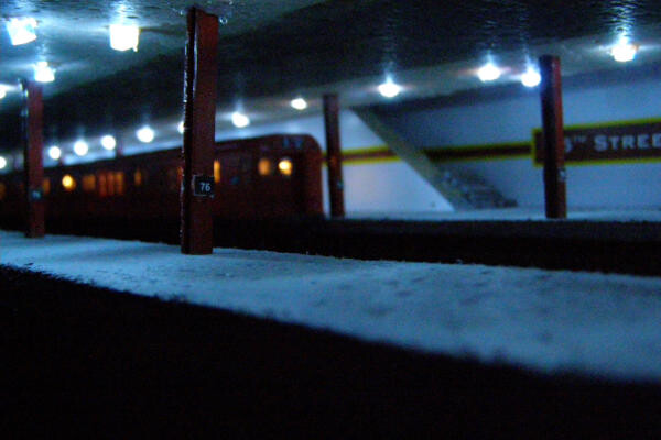

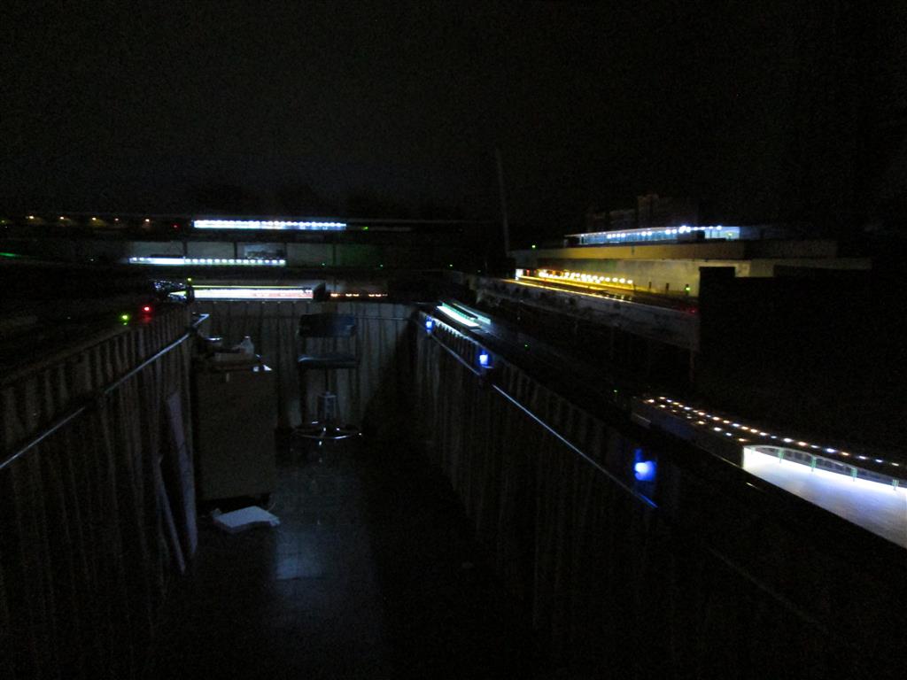

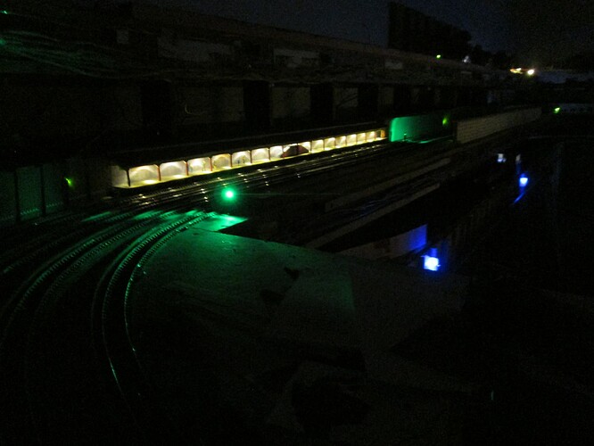

I do not know much about night time, it is all the same in a subway tunnel.
But I do have some interesting “night time” photos of my layout:
It is a simple matter to turn off the room lights and let the LEDs speak for themselves.
Broadway Lion
Wow!
