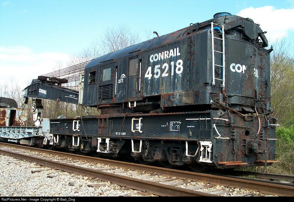

I belive that this is a drawing of the 490900-490905 series PRR 250 ton cranes from Brownhoist. Here is a photo from RailPictures.net of 490905 (now Conrail 45218) in 2003:

After looking at the cranes, it appears that the wheel size is very close or the same as is used on freight cars.
