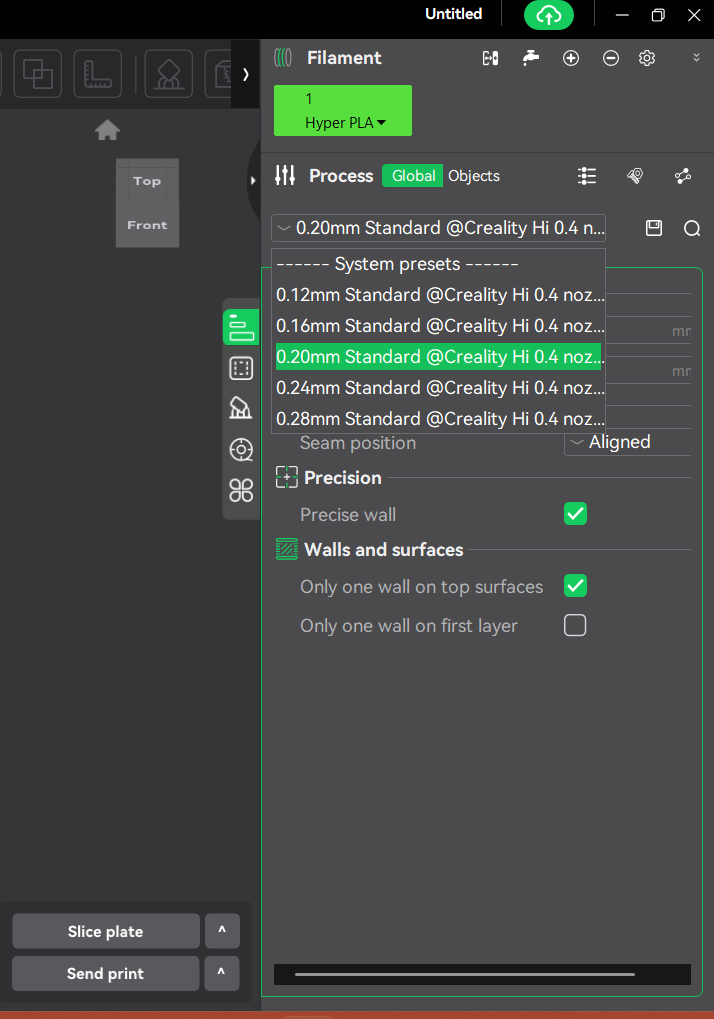

I’m unfamiliar with the Creality slicer, but I installed it to take a look. I found this:
I’d recommend that you use a smaller layer height. Unless that’s what you’re referring to when you say
In Cura, when a model or part thereof is considered to be unprintable, it shows up in the preview as looking like the negative shapes in Tinkercad. In the Creality slicer, it simply disappears from the preview. Whether the part of the model is unprintable or not seems rather arbitrary. I’d recommend that you check the preview and make sure that your details are there. If not, I’d play with the settings until they do pop up.
Also, a 4 mm nozzle is huge! I assume that you mean a .4 mm nozzle? I don’t know the exact capabilities of the printer, having had no experience with the particular model, but I would assume that it should be able to do your benches with that nozzle.
