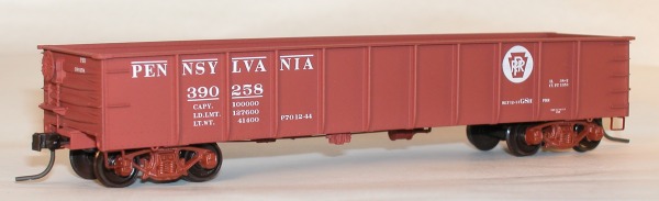

I am really looking forward to when Accurail finally releases these 41’ gondolas:
Click picture to enlarge
Most gondolas are 46’ and larger. The only ones currently in the 40’ range are a Athearn BB and a few resin kits. Even though I don’t really have any more room on my layout for more cars, I’m going to have to make an exception with these.

Just so you know, the Accurail PRR gon is not accurate for the Pennsy, they still had plenty of the Bowser Style gons (Class GS and GSa) so never bought any of the style that Accurail is making.
I looked at the PRR picture up above and the car is listed in the GSh and a built date of 1944. What really happed was the Pennsy rebuilt the following classes into the GSh class in 1944
GSh - Rebuilt from Classes GS, GSa, GSb, GSc, GS, Yankee Clipper makes or made a model of the GSh.
Rick
Then, for which roads Accurail gondola IS accurate model?

I notice from the posted picture that there’s some pretty decent brake rigging showing and that the corner steps are pretty fine. Does anyone know if the grabs are free standing or are they still cast on? I can’t tell from the picture.
