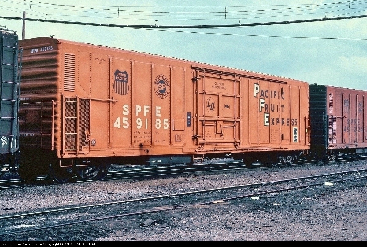

Anyone know what type/kind of trucks this equipment used?
100ton, 70ton?
Thanks in advance…
100ton, 70ton?
Thanks in advance…
Look to me like 100 ton ASF Ride Control, or 100 ton Barber S2
This looks kind of interesting, from Dec., 2003. The model info on the last 2 pages might be somewhat outdated.
http://mrr.trains.com/~/media/import/files/pdf/4/c/c/mr_pi_5-06_freightcartrucks.ashx
Mike.
Judging from the numbers written on the sides of the cars:
I’ll go with 70-ton trucks.
Ed
70-ton Barber trucks were typical http://www.railgoat.railfan.net/spcars/byclass/reefer/index.htm .
The closest representation in HO would be the ExactRail model of this truck https://exactrail.com/collections/ho-scale-wheels-trucks/products/70-ton-barber-s-2-trucks-w-standard-110-metal-wheels .
The FGE built cars (interior post) are 100 ton cars.
