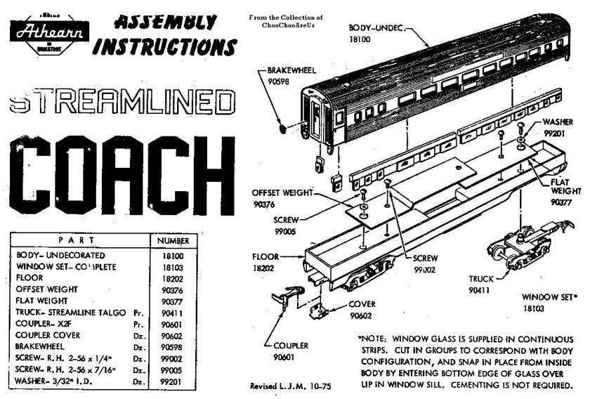

Cars are derailing on a very slight curve going into a straight bridge track. They are streamliners with plastic wheels. I have put a level to the spot where they skip off and track is level. I have checked the track with NMRA guage and spacing is perfect. The odd thing is that if i let one of these cars go on its own they zoom around my layout like a bat out of you know where. It is just this one spot that they skip off. I got some lead auto weights in 1/4oz that are adhesive. There is no place on the underside to stick them to. I can’t find a seam on the car to try to open it so I could put the weights inside. I know there has to be a way to get inside. All my other freight cars,etc about 50’ have no trouble. I am really disappointed because I run two sets on my layout and I wanted one of them to be a passenger train.
Frustated-Tom
Tom, the wonderful “HOSEEKER” websirte has diagrams to all the Atheran kits (and other makes as well) so it should help in figuring out how the shell comes off the frame
here is the link to the passenger car page
http://hoseeker.net/AthearnPassengerCarsInst/streamlinedcoach1975.jpg
Dave Nelson
