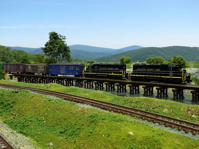

Words emphasized by me. When you say “back to back”, do you mean with the front of engine 1 pointing in one direction, and the front of engine 2 pointing in the opposite direction, while running DC engines?

Hi Stein,
Not sure where you are going with this, but it makes no difference which way the engines are pointed in DC operation because they will all travel in the same direction.
For instance, in this picture I have two engines pointed in opposite directions but they will both pull in the same direction:
