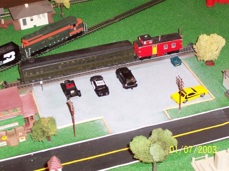

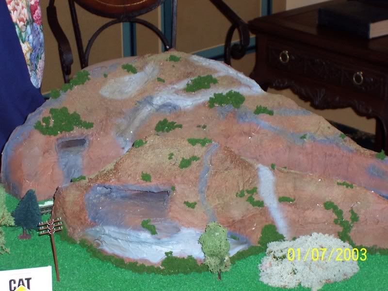

A few photos of the layout we built at work

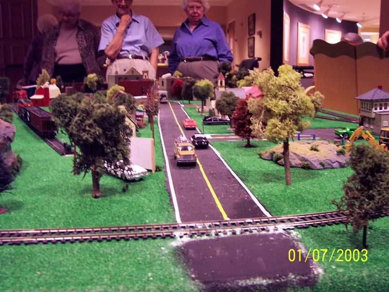

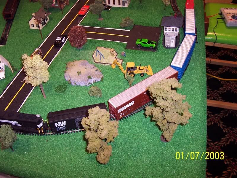

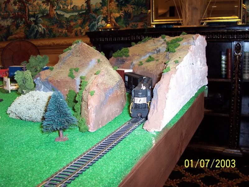

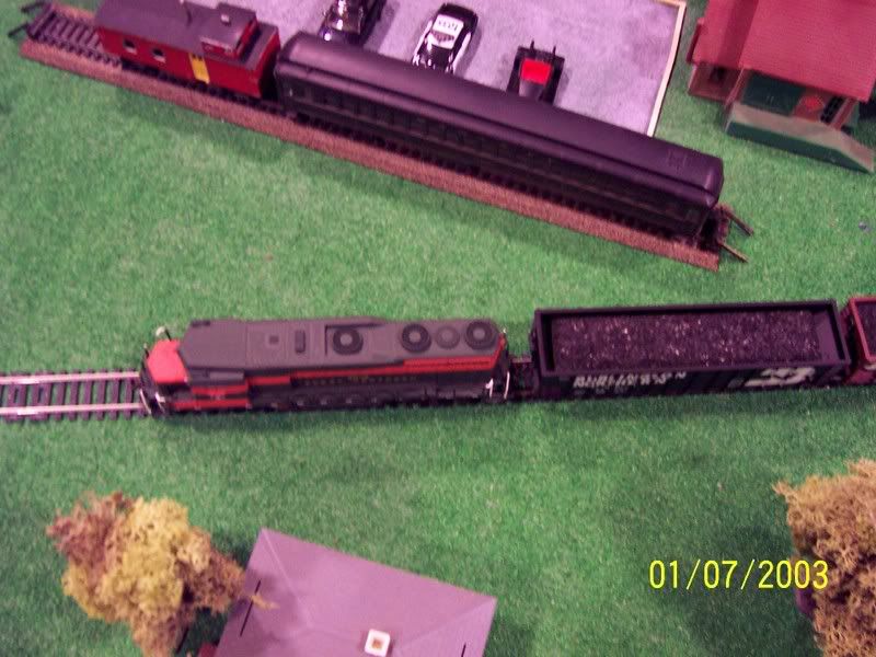

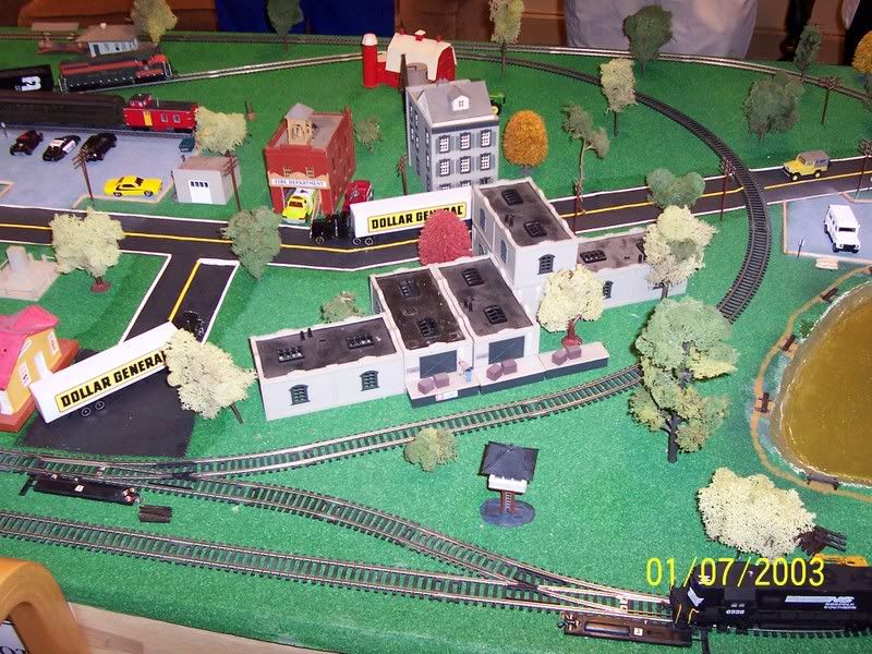

Well here it is our lay out. It is 4’x8’ with code 100 Atlas track and very simple ground work. It was a hude hit.

Seems I am not the only person with out ballast and on a green matt/ out door carpet in my case. What I was most taken with was the highway. What did you use?

COOL!!! The guy in the blue shirt in the first pic sure looks like he’s enjoying it. I think it’s great what you folks are doing. [tup][tup] I think someone here has a tag line-“your never too old to have a happy childhood.”
The highway was simple. We drew it out on the grass mat with marker then misted a watered down solution of alcohol on it. After a few seconds we scraped off the grass and let it dry. We then painted the area black. The striping was done with pin striping tape from the auto parts store.

yes everyone enjoyed it very much. I also enjoyed building the layout. The most fun for me was building the mountain and I think it turned out great.
