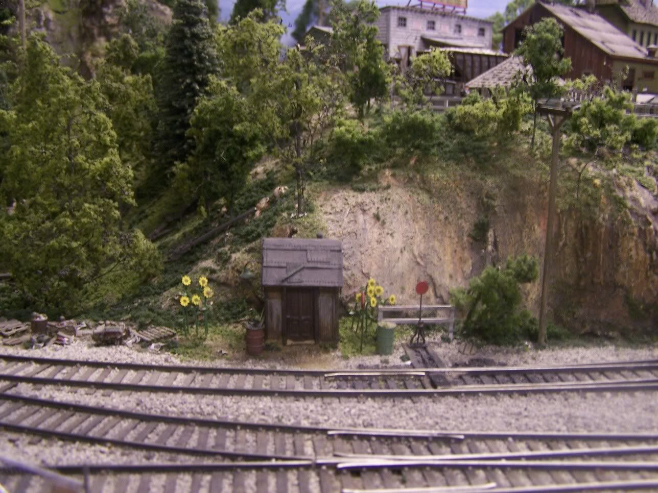

I use regular lunch bag material to make my tar paper roof from. I cut the bag into 1/2 inch wide strips x 2/12 -3.0 inches in length. I then paint the paper with a mix of Floquil’s Grimmy Black and Grey. I like to use random strokes when I mix and feather these colors. The last step is to is to add “nail marks” by using a Vintage reproduction or Micro-Mark pounce wheel. This is done using a metal straight edge, 1/32 inches in from the edge of each strip. Finally, I install the tar paper onto a cardstock roof using full strength Elmer’s glue.
Here are pics showing the end result:
