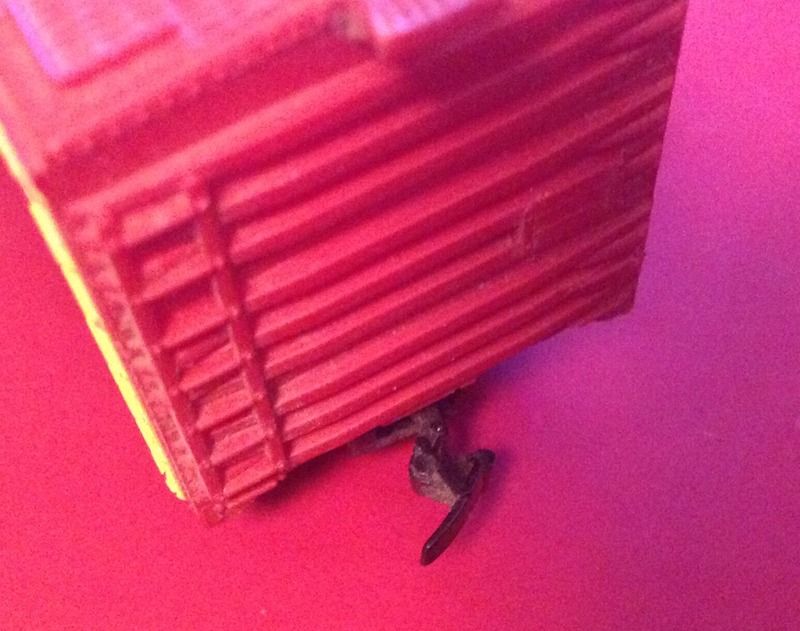

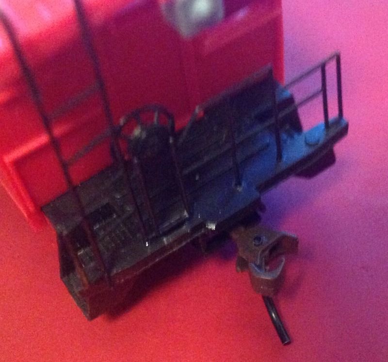

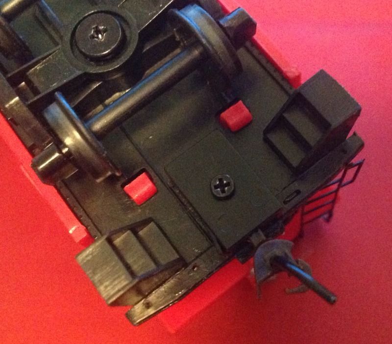

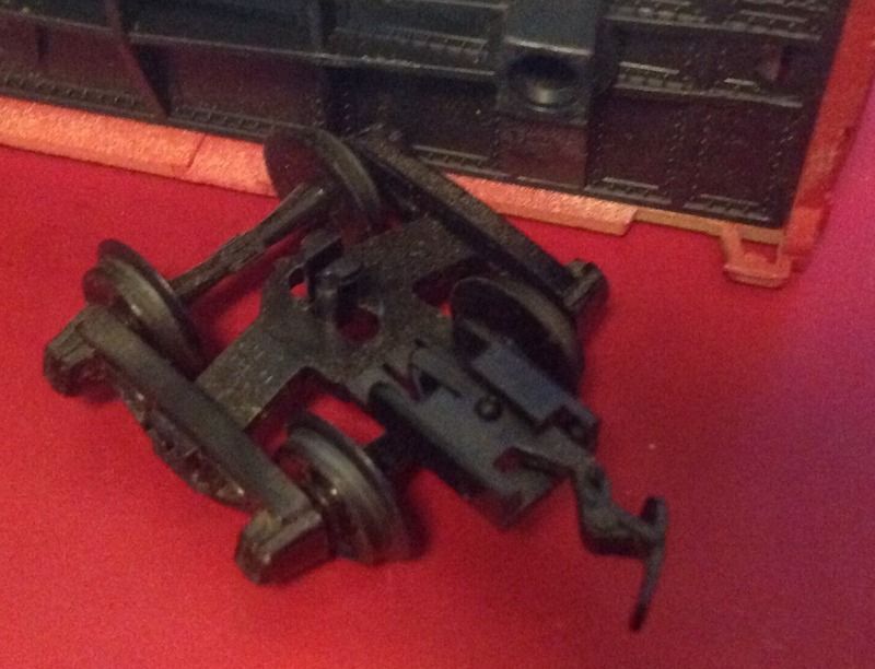

These are whats on the Sante Fe set.
and as you can see on the underside the coupler is attacked and accessible on the body of the car.
the problem is the other cars I bought have this style of couple that do not hook up with the newer ones.
and they attach to the truck which just unsnaps from the entire car.

Can’t see any photos in your post so it is hard to give a good answer. It is possible to buy both replacement couplers and replacement trucks.
The knuckle-style couplers will all work together, after a fashion. They will not work with the stylized “X2F” coupler, which is a one-piece plastic molding with a round pin hanging straight down. The knuckle couplers have a moving knuckle, and some sort of a spring to hold them closed.
One solution is to cut the truck-mounted couplers off the trucks and replace them with body-mounted knuckle couplers. www.kadee.com has couplers, conversion kits, and some tables that tell you which couplers will work on most cars. Look at http://www.kadee.com/conv/hocc.htm
The cars you bought off of EBay have what is known as horn hook couplers. They were phased out about 20 years ago. And as you found out, they are not compatable with the newer couplers.
I would contact Kadee Couplers ( www.kadee.com ) about converting the EBay cars. To save money, you could just replace the horn hook coupler on one end of a car converting it to a transition car. This car would connect to your new set and allow the use of the EBay cars behind it.
May I suggest shopping at M.B.Klein ( www.modeltrainstuff.com ) for all things trains and avoid EBay like the plague. If you can build models from kits, Accurail and Bowser make some very reasonable priced freight cars. And, they are made in the USA.
I my experiance, it’s not worth the time or money to upgrade these very old train cars.
South Penn
It is not a lost cause. The older less realistic couplers are sometimes called “horn hook,” sometimes called “X2F,” and sometimes called NMRA couplers because a committee of the National Model Railroad Association came up with the design but it never became a standard or recommended practice of the NMRA. Most train sets in HO came with those horn hook couplers from the mid 1950s to about 2005, and some continue to have them to this day.
The knuckle type couplers on your Santa Fe set are the way to go and the best ones are made by Kadee. A somewhat over sized version called the #5 is still very popular but Kadee has a vast array of them for all sorts of situations.
Since couplers mounted to the car bodies are just better running than those connected to the wheelsets, I suggest you snip off the horn hook couplers from those cars (snip or cut away right to the bolster, to make room) and purchase Kadee #5s that can be screwed or cemented to the car floor. It might be necessary to file or chisel away some of the floor detail so there is a perfectly flat surface to mount the coupler draft gear box. You will also want to make sure that

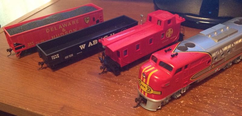

Thanks for the speedy advice. I’ve emailed kaydee to see what their recommendations are. Just for kicks, here are the the engine and cars from the set I bought. These are the modern couplers (obviously)

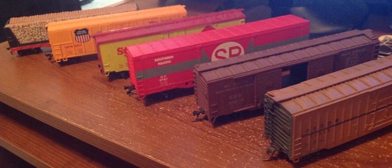

And these are from the lot I bought on ebay. Incidentally I got all of them for $9.00 but they do need a bit of work. 2 of them need new trucks.
I am considering just replacing one coupler on one car and using it to transition between the old and new. It will mean I can’t use my caboose but what the hey, it wouldn’t have a caboose anyway most likely these days. Maybe I’ll save the caboose for when I buy some coaches.

Another solution is to keep the existing trucks and replace just the couplers. The type of trucks you are dealing with are know as Talgo. Kadee not only makes couplers they also make an adapter and insertion tool so you can keep the Talgo trucks and upgrade the couplers.
