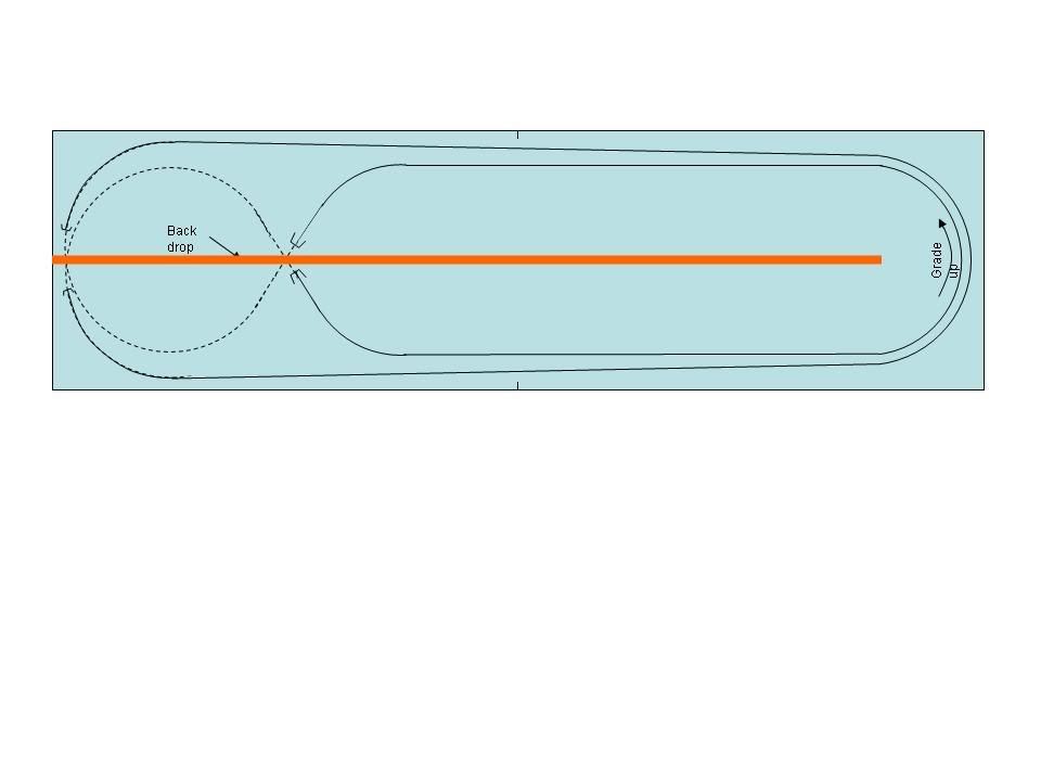

I’ve had this idea brewing for a while:track plan 1
I like it because it provides a long continuous run. You could add curves to make it more interesting, and sidings and spurs. I think your trestle could fit into a gorge on the straight stretch near the edge of the table just after the routes diverge to create a loop.
