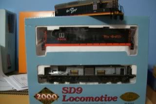

I certainly appreciate this excellent reminder. I won this early run Rio Grande P2K SD9 on ebay a year or two back, new in the box. (got the Burlington SD9 shell on another auction, earlier)
To this date I have not taken the chassis out of the box to test it on the track. I’m planning to install DCC in it, so it will have to be the hard wired. I’ll make certain to disassemble the trucks and clean out the old lubricants, which may likely be dried out, and relube it with the Labelle grease. I also plan on replacing the factory bulbs with gold-white LED lights.
