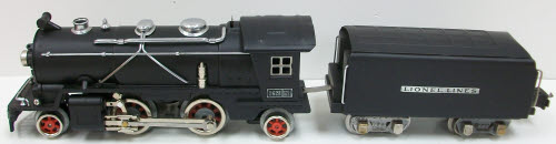

Well perhaps “better detailed” would be more accurate. For example, a late 1930’s American Flyer O gauge steam engine looked like this:
http://www.classictrains.com/storeimages/OAF429-1.jpg
While a typical O gauge “toy train” engine (in this case, Lionel) looked something like this:
http://pictures.trainz.com/2010/January/Pictures%2001-11-10/m43_001.jpg
At that time true O scale trains were either scratchbuilt or fairly difficult kits except for a couple of 1/4" scale Lionel engines like the Hudson, so many folks bought the American Flyer stuff and better Lionel stuff and just tried to ignore the inconsistencies I guess.
