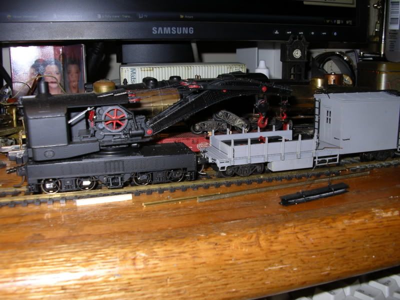

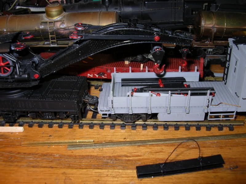

Hello well it took some time but here are some pics of my crane no boom car yet but on its way. What do you think? Have a nice day Frank
Budliner good looking models. I especially like those strongbacks laying on the deck of your boom car. Where they part of the kit, or did you scratch build them?
