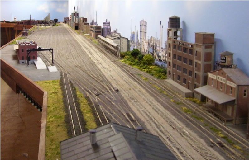

Good pics though. You could about use those yard pics for a “how to” on laying out yard trackage!
I enjoyed that! I can’t imagine all the hours of work that went into that wonderful yard. Very nice photos.

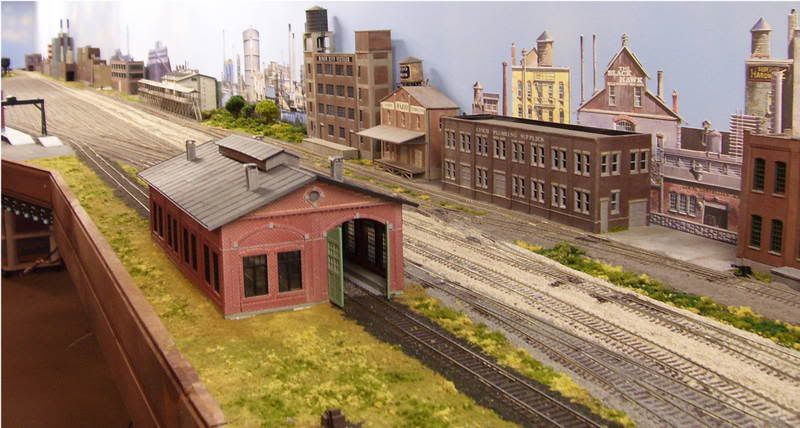

The track I laid in the yard was done with methods that are fairly standard. The ladder is made up of Atlas #6 turnouts laid end to end which yields track centers of 1 3/4". They are controlled by Atlas undermount switch machines. The one material I used that doesn’t seem to be popular with other modelers is the roadbed for the yard tracks. It is 1/8" blue foam board, the same material that is widely used in 1" and 2" thicknesses. This stuff comes in a bundle folded up like and accordion. It mates perfectly with WS foam roadbed. The individual sheets are about 2’ by 4’. It is by far the most economical material I’ve seen for where wide areas of roadbed are needed. I forget what I paid for it but it wasn’t that expensive and I used less than half the bundle for the entire yard in which the longest track is about 25’. I’ve mentioned this stuff on many different threads but no one has seemed too excited about it and I haven’t come across anyone else who has used it for model railroading.

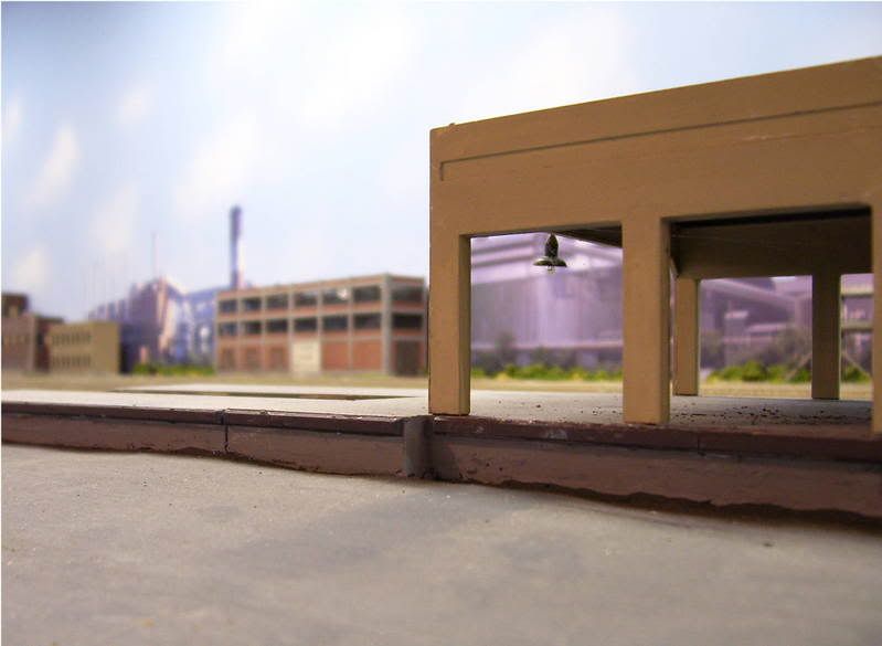

Those are some great photos. They have a real eerie look about them. If there were some weeds growing between the rails in the second photo, it would definately look completely abandoned. You have a very nice layout.
Eerie was just the feeling I had when I entered the train room the day after I did the track cleaning in this area. Besides reminding me of the abandonment of the NYO&W, it also created the feeling of a Twilight Zone episode. “WHERE IS EVERYBODY!!!”.

Can you tell me how long your yard is? For example, from the water tower at the far end next to the yard ladder to the building at the near edge of the picture…outstanding trackwork!

I am wondering too. And the width at the widest point, please.

From throat to throat, it is 8 paces, approximately 24-25 feet. I don’t know if you can tell from the pictures but it is actually two parallel yards, one for eastbound and the other for westbound traffic. On the far end, a single ladder serves both yards. On the near end there are actually two separate entrances, one for each yard with a caboose track between the two entrances.
The width is 12 tracks wide counting the thoroughfare track at the far left. From outside rail to outside rail it is about 21". There are 5 tracks in the longer westbound yard which is to the right of the photo and the shorter eastbound yard to the left is 6 tracks wide. I actually planned to have one more track but after the track was down, I realized the last track would be so short as to be useless. The left most track of the eastbound yard is a caboose track and it holds 5 cabooses. The westbound caboose track which runs diagonally between the two yard entrances holds 6 cabooses.
