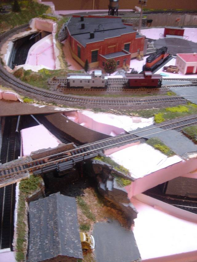

This picture shows five liftoff areas:
Here’s the same shot with the liftoffs removed:
These are all small, of course, not man-sized, but the principle is the same. Mostly, I’ve disguised the edges by using irregular shapes, which the eye doesn’t catch the way it sees a straight line. Then, before I put on the final scenic cover, I put a strip of plaster cloth, about an inch wide, over the seam. On the top (removeable) part, the plaster cloth goes right on the edge. On the stationary section, I put down some plastic wrap before I apply the plaster cloth. This prevents the plaster cloth from bonding to the scenery, but still lets me form it over the contours. Once the cloth hardens, I remove the plastic wrap and apply the scenery, with a lot of ground foam over the seam. After it all hardens, it only takes a bit of effort to break away the bits of glue that hold it together. The plaster cloth comes up with the liftoff, but when it goes down, it covers the gap and the ground foam hides the fine edge.

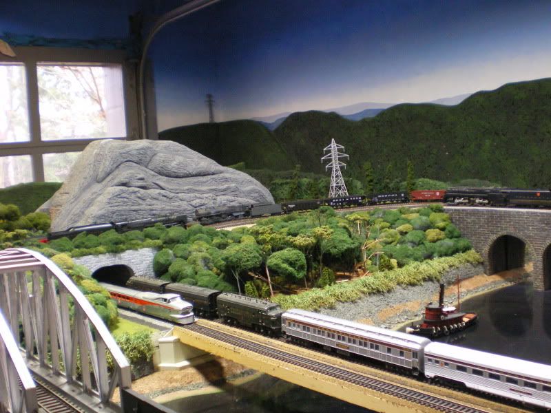

Here are the photos of one of my lift-outs. The scenery is not complete as can be seen on the bare rock formation in back of my Horseshoe Curve. Also the transition area by the river edge needs additional foliage. The next few months are my time to work on the layout. I hope to finish a lot this time around.
All I use is 1” pink foam board for everything you see. I carve it and glue it together. I added a lot of ground cover, fallen leaves, stumps, fallen trees and different bushes. Landscaping this lift-out would have taken me several hours of work but by making it on the bench instead of on the layout it was done in about ½ hour.
The transition seems are covered by scenery in a mixed manner. Try to avoid putting bushes, etc. in a straight line and don’t be afraid to glue bushes on walls, rocks, and buildings if that will aid in covering straight lines.
Here is the lift-out installed:
Here is the lift-out removed.
