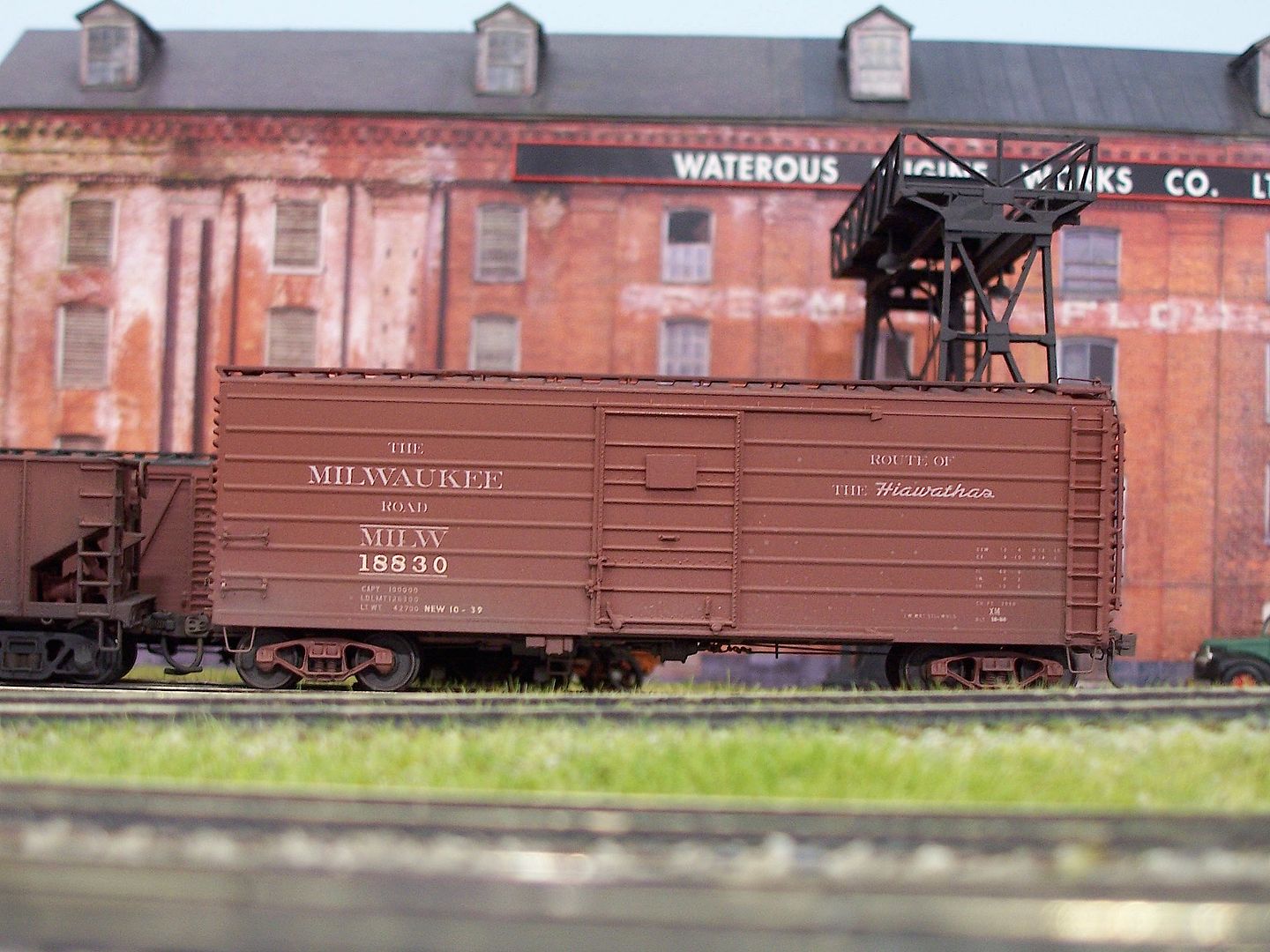

The only Accurail model that was a bit of a disappointment for me was the recent MILW ribbed-side boxcars. Generally there is very little-to-no flash on Accruail kit parts. I had to do some cleanup to the underside of the MILW ribbed-side boxcars shells to get the underframe to fit properly, as well as clean up the roof walks.

If I’m not mistaken, Accurail bought the moulds from RIB SIDE CARS, but I’m not sure if they’ve been used as-is, or perhaps somewhat modified.
I bought one of the RIB SIDE kits, as the BLT. date of those cars fit well into my layout’s late '30s era…
I did modify the brake gear with a few more details, plus some free-standing grabirons on the sides and ends, and on the runningboard laterals, too.
Beware the built dates listed on Accurail’s site. The date often applies to a prototype car for which their model is not approriate. For example, the Pullman Standard 4750 hopper they make first appeared in 1972, but Accurail lists paint schemes for it dating to the mid-1960s, including roads that were already merged out of existence before the 4750 was available from PS. The same is true of their ACF 4600. Whether you’re OK with the anachronisms is of course up to you.
My understanding is that they’re just shooting the Rib Side Cars molds without any changes. As soon as I read the post about the flash I thought, “ah, because they’re not Accurail molds, so there’s some differences at work.”
