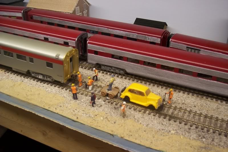

The passenger cars all hand painted with acrylics, as well as the car and some of the figures.
These are real aluminum coaches that i hand painted with acrylics, two coats, same for some of the buildings in the back ground.
This station has been seen several times, it is hand painted with acrylics to look like wood.
So it is the paint, stirred well and mixed; thinned just right if neccessary, and good brushes and stroke in one direction and allow the paint to dry really well before the next coat.
