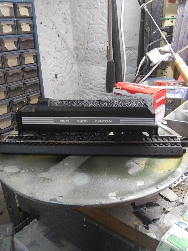

Added brass parts to my Bachmann Niagra tender.
The tender of my Bachmann Niagra was too light and the cheap plastic wheel sets caused frequent derailment.So I found brass upgrade parts from Key Imports on The Bay!Solved the problem!

C’mon, Kevin! It’s a counterweight so the tender doesn’t tip forward. [:P]
Ok I used it as a wheel block alignment tool while I drilled and tapped the holes in the tender floor.

Nice work!you went above and beyond to build the tender that you wanted !
Painted and installed!
That looks good, and should track a lot better than the lighter plastic version.
Yes sir!a very worthwhile modification!
Okay, that’s creative!!
I love the ‘heft’ of the whole wheel system. It gives a good indication of how much weight the tender was actually carrying.
Nice conversion!
