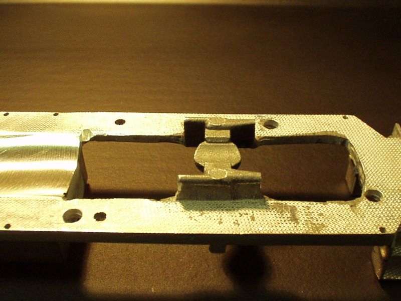

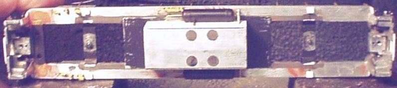

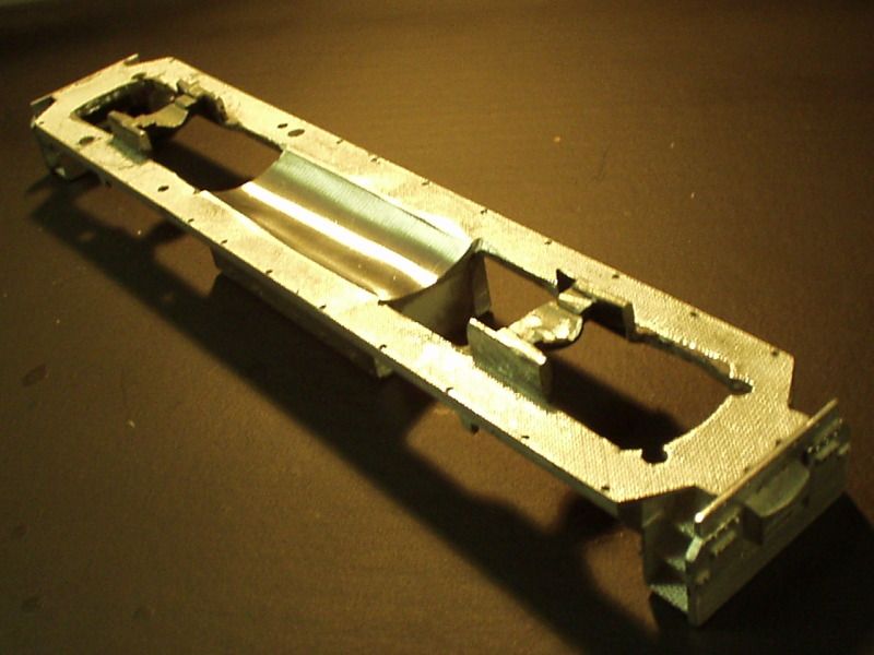

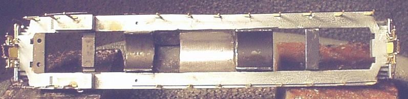

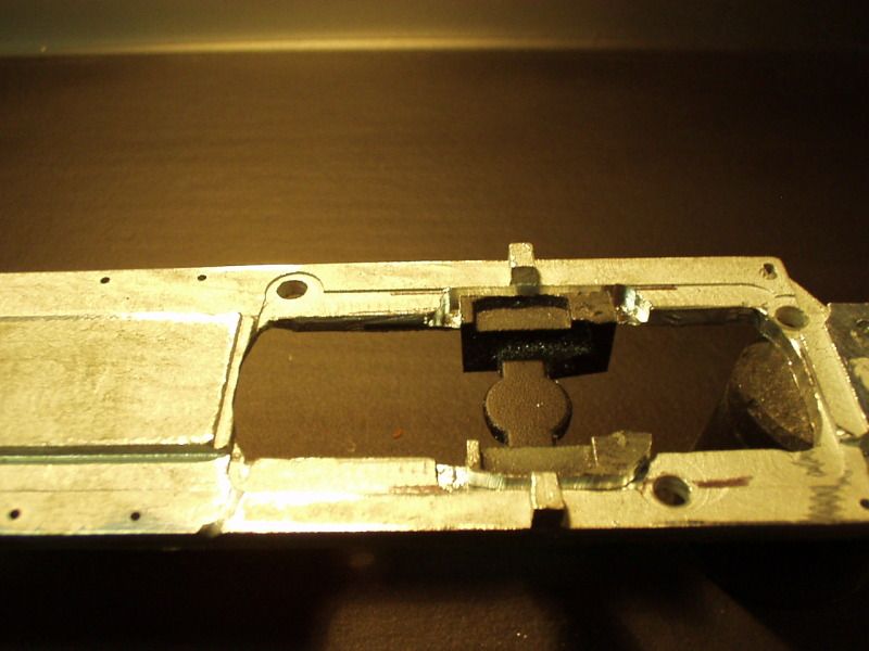

My solution to both improve the pickup and make the Hobbytown RS-3 chassis & drive compatible with Atlas, Kato, Athearn was to rebuild the chassis to accommodate a Proto 2000 drive and fuel tank/motor mount. Here’s some pix of the frame modifications:
Hobbytown RS-3:

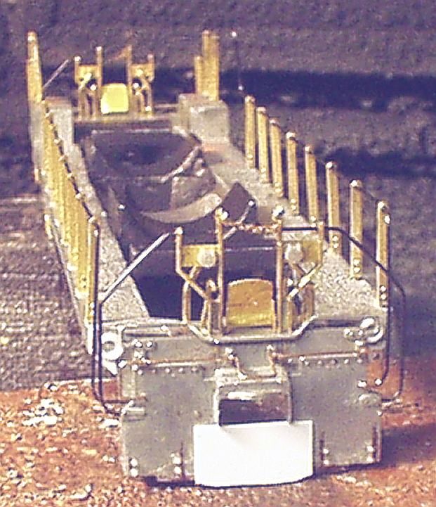

I also did the same with a Tiger Valley RS-36, using an Atlas drive:

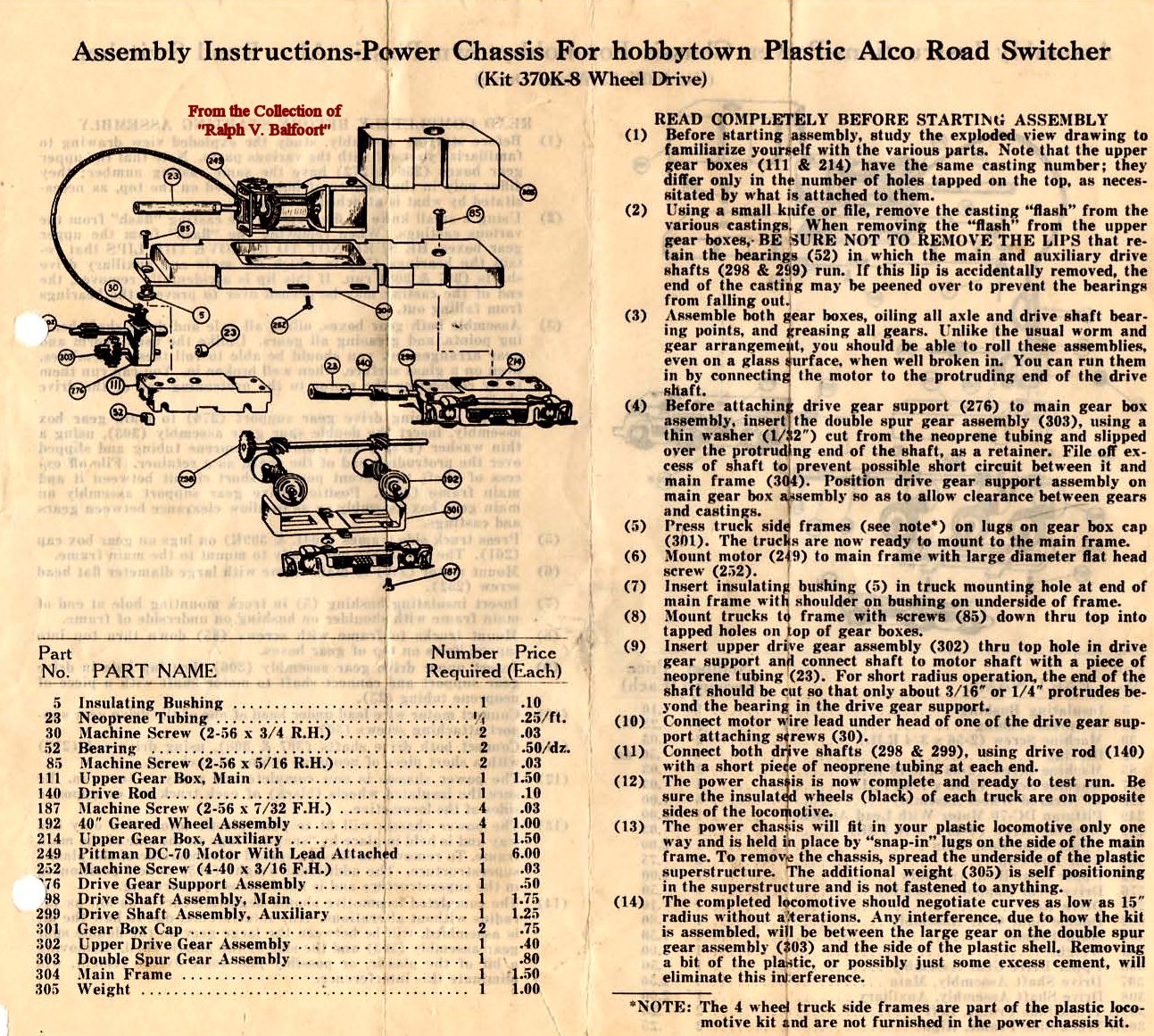

You should be seeing a wire from the motor to the front truck, as shown in this picture:
The other truck takes care of itself by being grounded to the frame–thus there’s no need for a wire.
And, yes, more pickup wheels would be a good thing. I would go with wipers on the insulated wheels.
