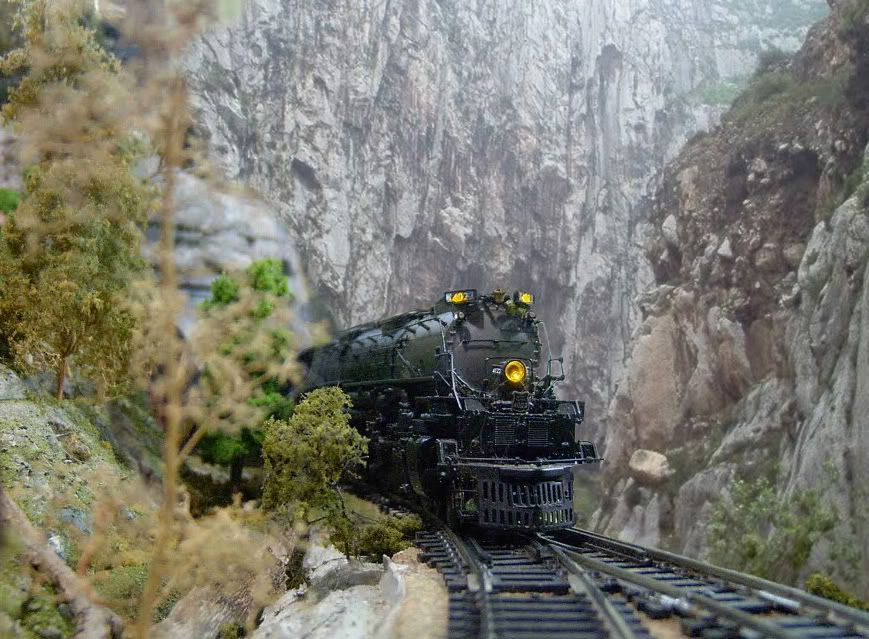

I couldn’t agree more with CNJ831. What you see below is a quick (20-minute) effort that gets the job done but not much more… I have too many honey-do things on my list today to really spend the time necessary to do a proper job.
When taking images with the objective of combining it with a digital backdrop, a lot of care must be taken not just with finding a suitable backdrop, but also (and more importantly) with the original image. In this particular case, the depth of field on the original is only so-so, and that presents a challenge.
Often when I do images of my own like this, I discover things that I’ve overlooked. Case in point for this image: the bell is upside down, and there are cobwebs on the loco. The track is not ballasted, so that’s a bit of a give-away too. Anyway, hopefully this is a decent stopgap for now. Cheers.
Good Job. Kens problem is now solved [:)]
RR, it was ringing! [:D]
What program did you uses?
Far as the added section, is there a menu to pick from or do you have to get the background picture your self? It sure looks better!

I used an old version of photoshop - version 6.0
I bought it in '01 and have never updated it, since it already contains 10 times more functions than I will ever use. Even back then it cost $500 or more. I think that since that time, a number of slimmed down versions have been released - Photoshop Elements and GIMP have been mentioned.
Finding a background image is your job - there’s no library to choose from. You can find backgrounds in various places: your own photos, photos on the web, photos scanned in from books, etc. Using your own photos is preferable not only because they are uniquely yours but also to avoid the unlikely but potential issue of copyright infringement. In addition, if you use your own photos, you can compose them specifically and intentionally to harmonize with the model photo… surfing the web on the other hand for a suitable image can be a tedious process and often, even if you find a suitable image, it will have a size and resolution much smaller than that of your model photo.
I suggest you try Elements or GIMP and see how it goes. Like CNJ831 said, you will find that to do it right takes practise and effort. This is particularly true if you want to add effects like smoke and steam - nothing looks worse than bad photoshopping.
If in the future you have a killer shot that you want manipulated, go ahead and send it to me and I’ll take a stab at it. I extend this offer to everyone on the forum - just don’t overwhelm me or expect same day service.
