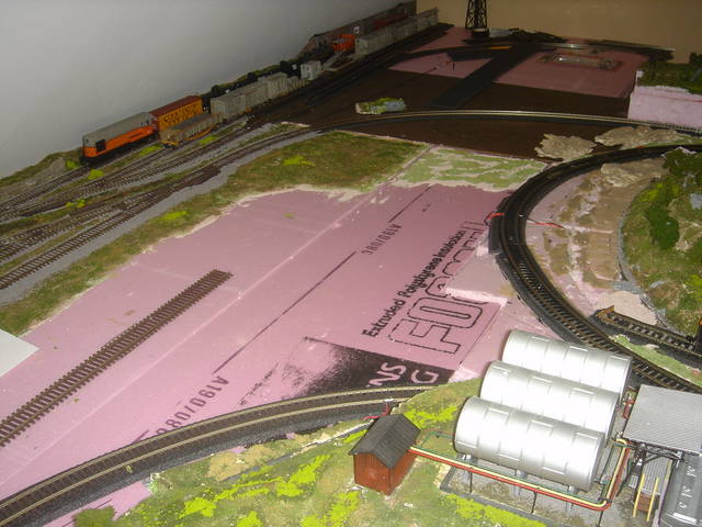

If you are not modeling a prarie or a manicured lawn, do something to break up the flatness of the surface first. I use pink foam for my layout base. You can use any other materials you like, even crumpled newspaper, to make “land forms” that will elevate the terrain a bit. Foam makes it easy to dig in and make basins and stream beds, too, but with plywood I would stick to putting in small hills. After I’ve made the bases for hills, I usually use plaster cloth from a craft store to give me smoother slopes:
This boring flat surface:
Became this irregular space which will have uplands and lowlands:
I like a rough surface, so I skim-coated most of it with Gypsolite, a gritty-textured plaster. The plaster cloth is pretty good on its own, though, and can also be painted.
After that, I like to paint a “camouflage” pattern, since I’m modeling an irregular natural area. Next, I do pretty much like everyone else has described with glue, turf and ground foam. I like to use several different shades of each, since once again it’s a natural area with plenty of color variation.
