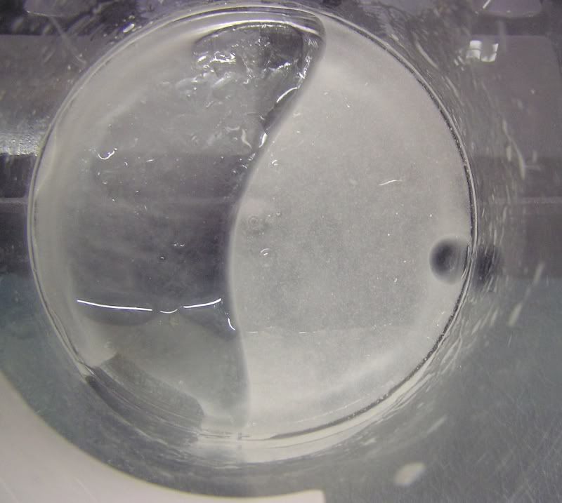

Don’t be tempted to water down the paint first. Use it neat. With the resin, at least, it sends the mix milky - and that’s actually quite useful if you want ice! [which I do]
