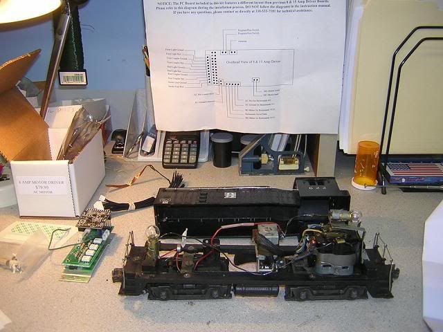

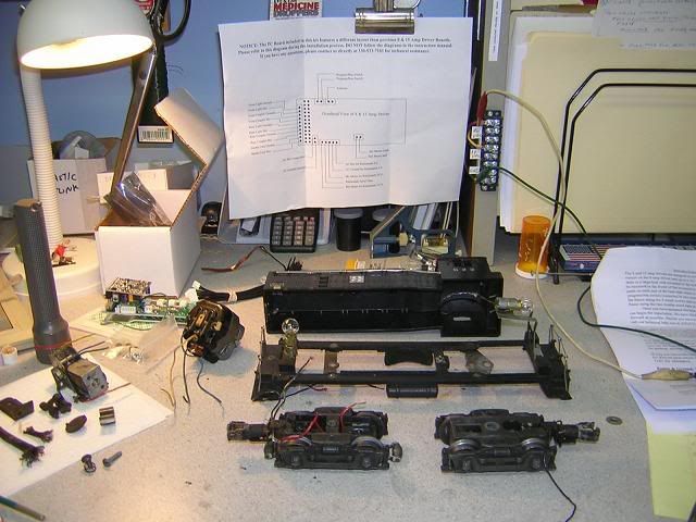

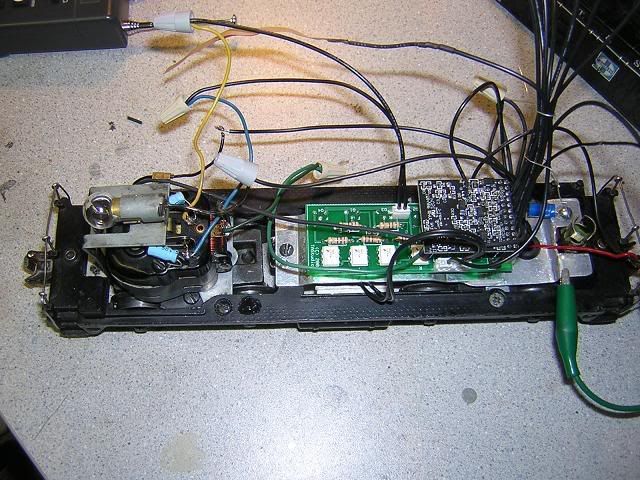

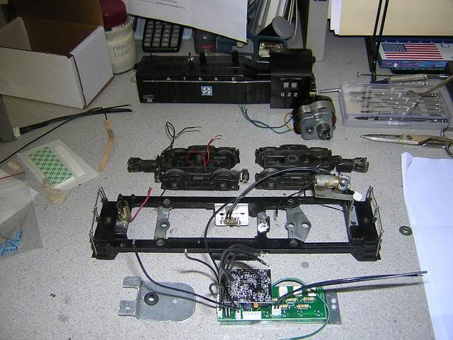

ok Roland I found these pics of when I was upgrading the 622 switcher.
Like I said after I installed the kit from TAS I had problems and after shipping the whole unit to TAS found out that the original motor field housing was bad and it was drawing around 10 amps which was more than the boards are rated for.
Well they were able to repair the motor and all is working fine.
testing the electrocouplers
This is good. I’ve done several with motors like that one with boards from Digital Dynamics. Always worked great. If I have a problem, I will know one thing to look for in trouble shooting. Thanks for passing this on to us.
