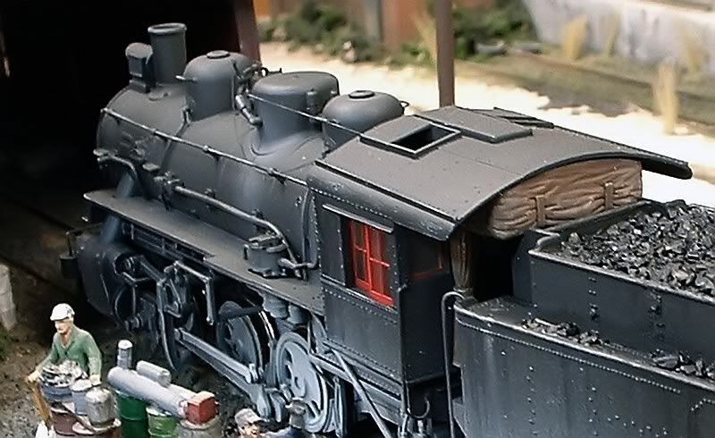

The Proto 2000 0-6-0 comes with a whistle cord. Here is a website with a nicely weathered 0-6-0.
http://www.port-kelsey.com/?m=200504
