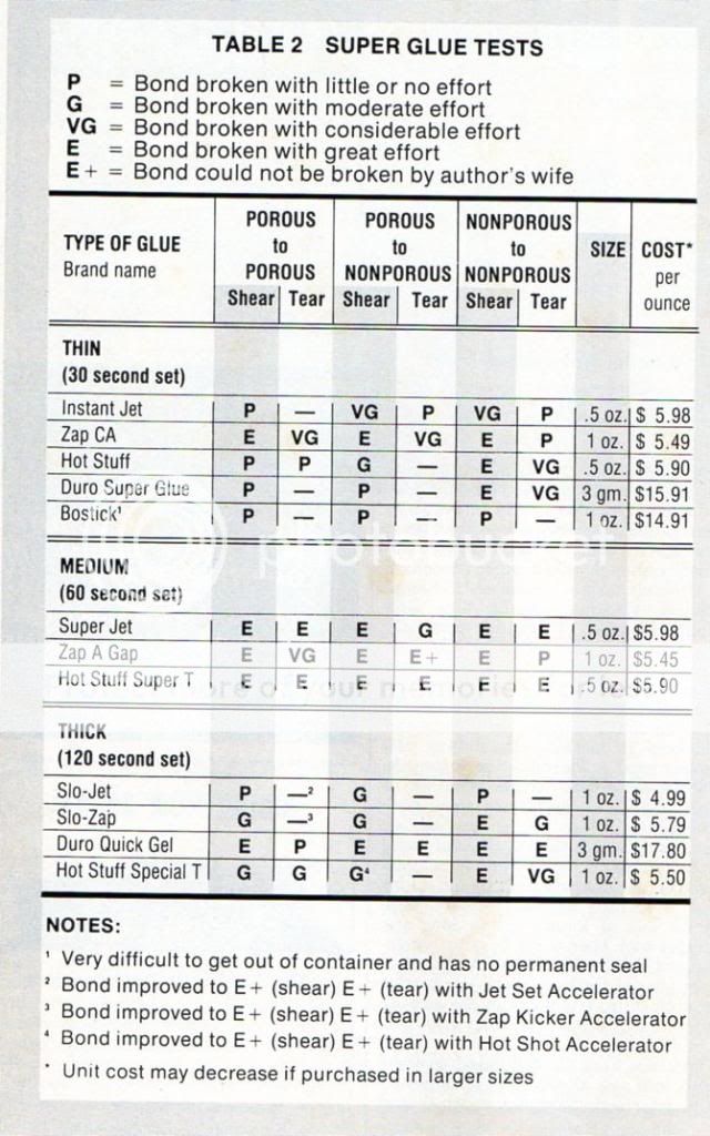

While looking through a back issue of MR (July 1988, I think), I came across an article about different types of adhesives, and it included a great chart of the different types of adhesives and their usage vis-a-vis different types of surfaces, slow vs fast setting, smooth vs porous surfaces, holding ability and some of the brand names. Has anyone seen an updated version of this chart, or one which is similar?
There’s a lot of glue out there these days, and a chart like this one would be a great help.

One good chart deserves another! Here’s the chart I found in the issue I cited, and I imagine the one in the '96 issue is probably similar, if the author used the '88 issue as a guide. Would love to see an updated one! Note the author’s comment about the E+ bond. Anyone out there have a copy of the April 96 issue with the updated article?
