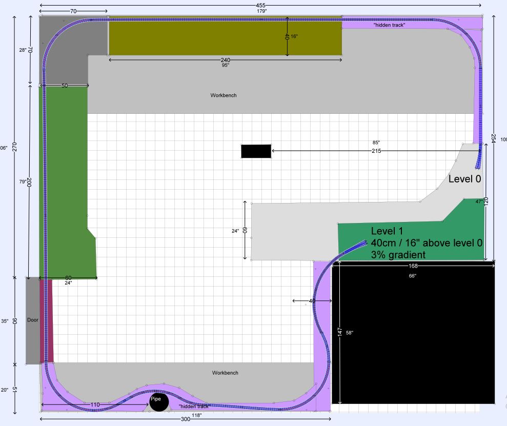

Do you have the same idea as me for a nolix route?
Im thinking 15" between the possibly 2 levels. In addition my plan is that the module is 4" thick. Anyrail says that the gradient will be 4,4%
That seems pretty steep.

Gidday Marius, the reason I suggested a nolix is that if I had a room with the same dimensions, a helix would not work for me as not only does it take too much space, in My opinion, but it would limit access for Me to the rear left-hand corner, as viewed from the door.
My idea for the nolix was that it ran completely around the room, so that the grade was workable for model trains. The reasons I wanted to know what your work bench and layout heights were, was to be able to workout the grade for the nolix. With a height of 51 cm/20â between the top of the rails, according to my calculations, a grade of 3% would be required. This grade should also clear your work bench on the left-hand wall.
A 4.4% grade makes Me cringe! I say this because the local Clubs Mountain Exhibition layout had a helix with a 46 cm/18â radius and a 4% grade and like a 1:1 railway, provided there was enough motive power, it worked well, but only going up! Going down the engines tended to surge and it just wasnât nice on several aspects. (I have some video of the layout in action, but wish that I had taken a more âscientific approachâ to show how different locomotives and train lengths behaved on that helix.)
Again, to My mind, a train, consisting of a locomotive or two, with seven 40-foot cars, and a caboose, total length of around 153 cm/5 feet, would not only be visually pleasing but also a practicable number of cars if switching moves were to be taken, should be acceptable with a 3% grade. (Of course, if you just wished to have a train circulate on the level, the length is as long as you wish.)
While the door opens out which is very useful, Iâm not sure how you intend to enter the room, your bottom of your âtop levelâ at 130cm/4â3â could be permanent if you were prepared for a âduckunderâ, and have the nolix as a lift out.(?) (I would personally use a wheeled office chair but do note that your floor levels are different.)
Please note that while others have expressed their valid preferences, the above are My personal preferences, and may not be best for you.
Cheers, the Bear. ![]()

Going around the room, I get 3% gradient, rising 16" from level 0 to level 1. That gives around 12" between the two decks. Is that a little tight for lanscaping?
Im not sure if a helix or nolix provides so much more to a possible layout with the obstacles in the room and need for keeping the work bench areas. I can only see that it gives one more small station/industry. Probably have to stay awake several nights to find the perfect solution. ![]()

You are correct, that in your situation, the nolix does only give access to on small industry. For Me the extra cost in construction, and rail to achieve that limited goal would not be worth it. There is the possibility you could have an extra module(s)/ (section) on the other walls, making them all on the one level.
