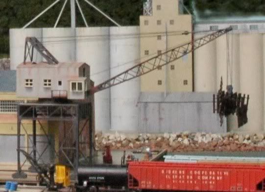

Weathering powders are a cheap fool proof way of weathering. Fool proof because if you goof you can wash them off with water.
The crane in the background of this pic was my first weathering with powders. And I only got better with time.
