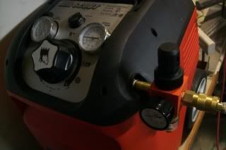

Just set your compressor and filters up properly and you’ll be fine. Your filter or filters (depending on your compressor’s size and output) should be on the outlet pipe that comes out of the compressor which would then be followed by a copper or brass nipple (threaded pipe) on which you would screw your coupler on to so that you may connect/disconnect your air hose. It’s quite easy.
My large compressor is down for now, so I’m using my smaller suitcase compressor for my airbrush jobs, pictured here.
