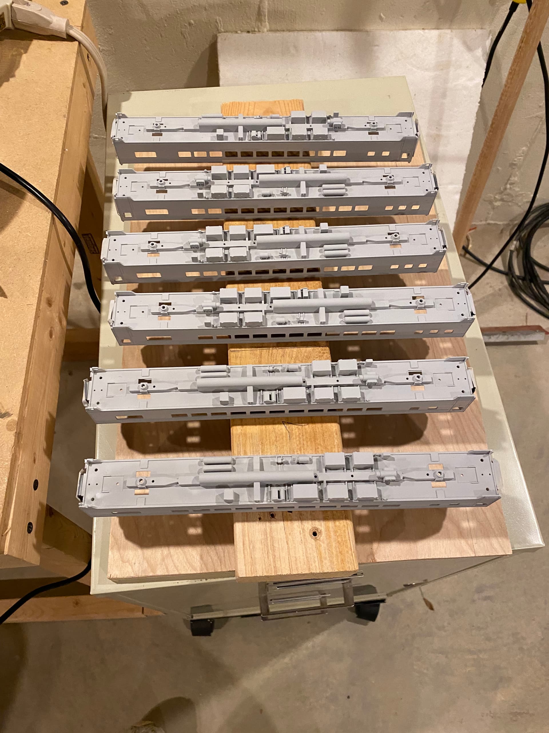

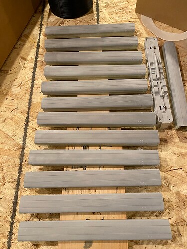

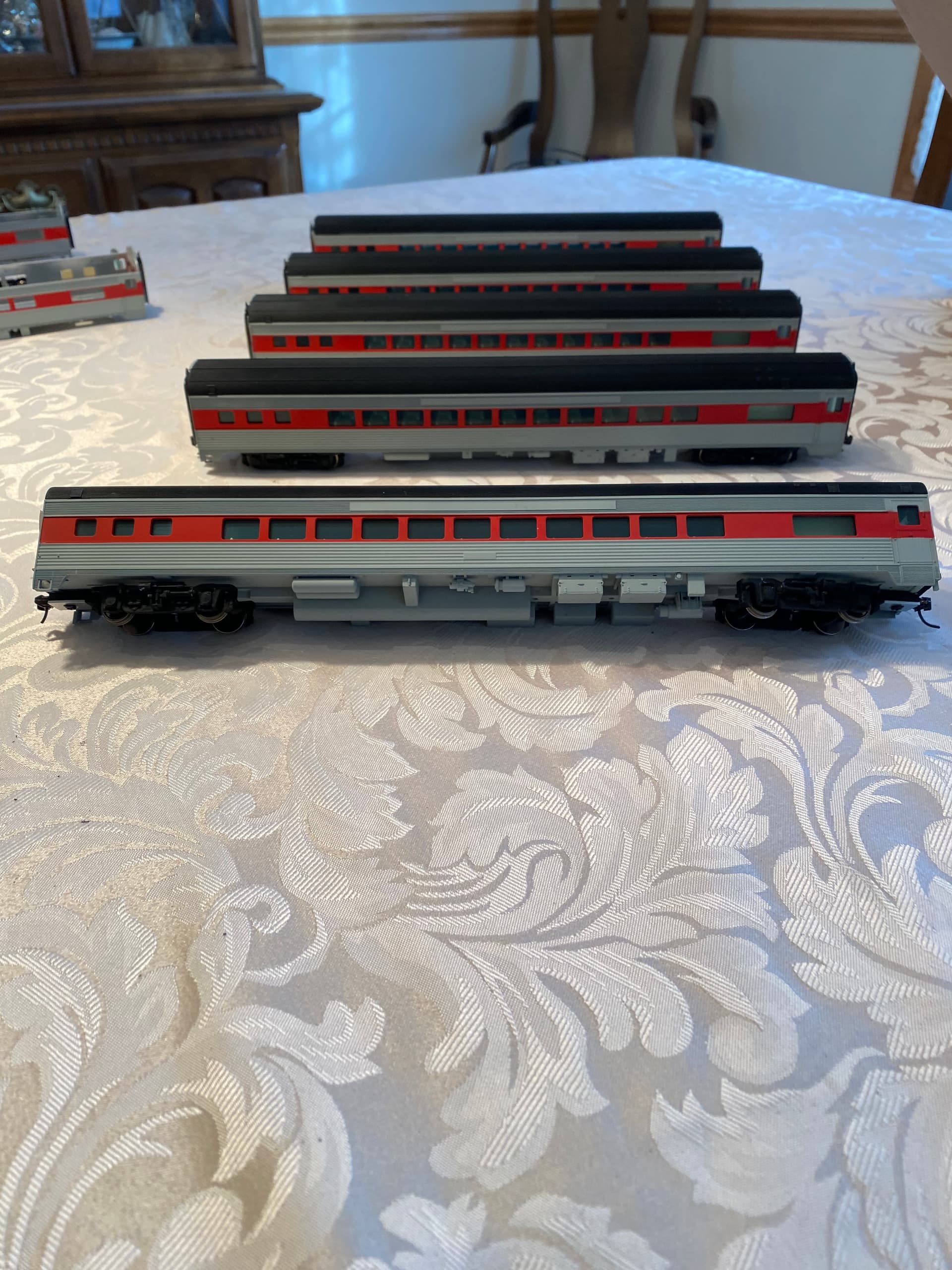

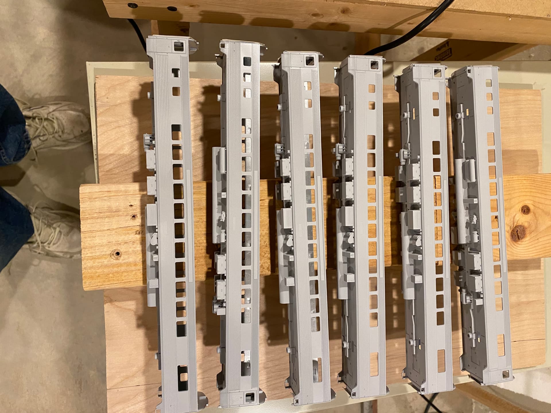

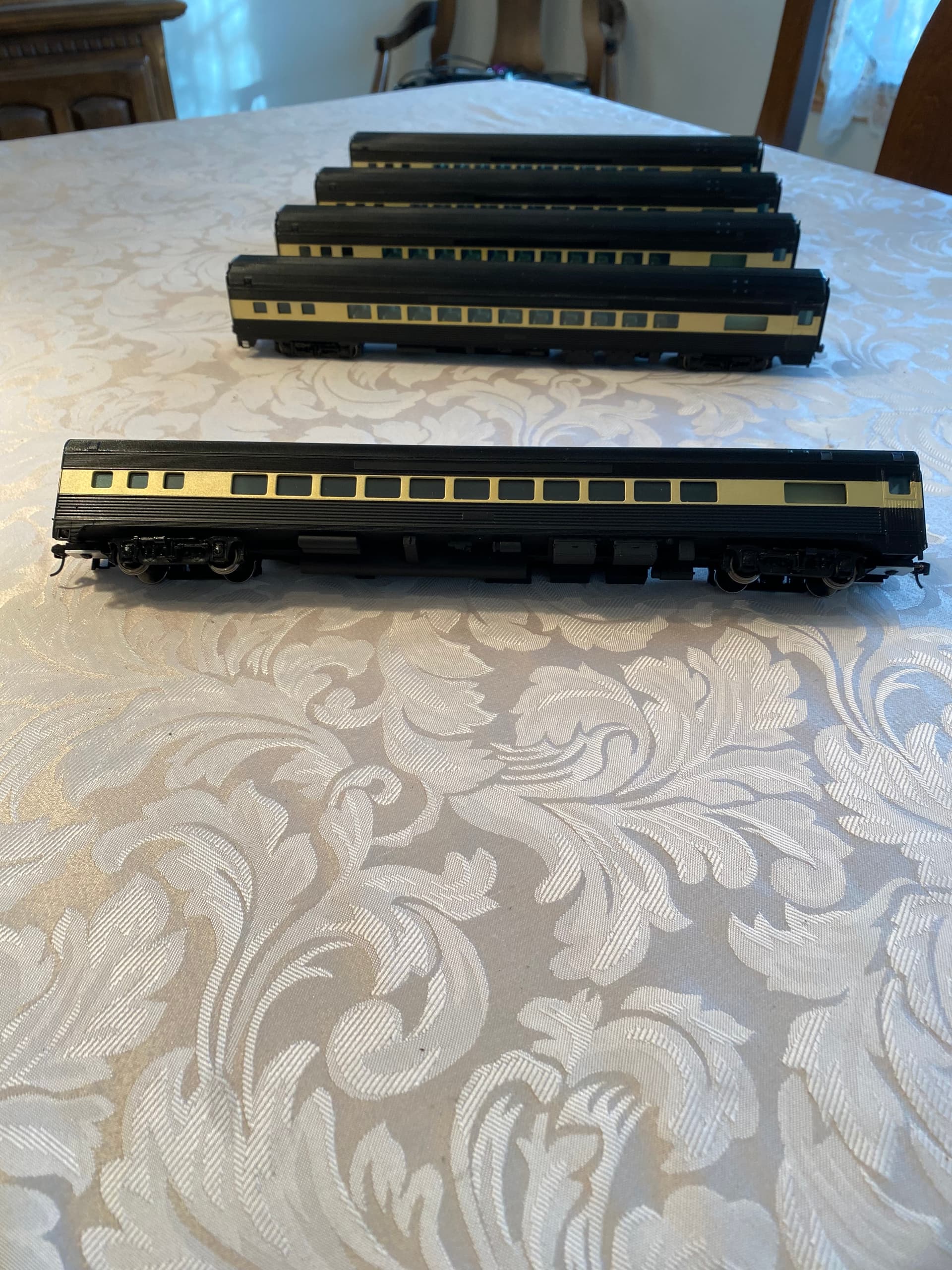

I bought 12 new Walthers Mainline passenger cars that were painted silver.
I sprayed an acrylic primer over the entire shells of the cars and then masked and sprayed them with acrylic paints. I used Tamiya primers and paints. It worked just fine with no loss of detail.
Here are the finished cars.

Good point, Dan. I should have mentioned in my reply that those Walthers Mainline passenger cars were unlettered.
