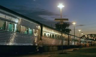

No, I wouldn’t laugh at all. Neat and unusual idea. I googled photos of that RDC unit and the best I found was a distant shot of the train facing forward. The finish looks a bit worn. Regarding the blue hue that you observed…remember that the colors/tones/hues of what you see on tv are not going to be 100% on the mark and SS surfaces on railcars tend to reflect blue sky conditions as with this Metrolner:
I’ve seen railfan YouTube vids where Amfleet cars look “bluish”. Yet, when I see Amfleet cars with surfaces that are in very good shape up close, they appear gray.
Just something to keep in mind.

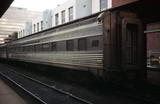

Here’s a photo from BCoolidge
The photo appears slightly underexposed but still makes for good reference material.
The Budd appears aged, grimy, and pretty dirty, but you can still clearly see reflectivity underneath that “stuff”.
For this appearance just go with Steps B and F. Add washes of weathering when finished. Don’t forget to use grime on the entire body, including the roof and ends.
It would be a big leap from the Walthers Pine Series’ appearance, but nevertheless quite prototypical!

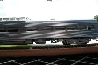

Posting these photos for a modeler that wanted to see a comparison photo of this dome car and a prototype in sunlight.
As is so often pointed out, photo images are greatly affected by lighting conditions. [8D]
Top photo: Prototype…Lower Photo: IHC Model
