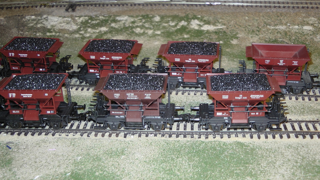

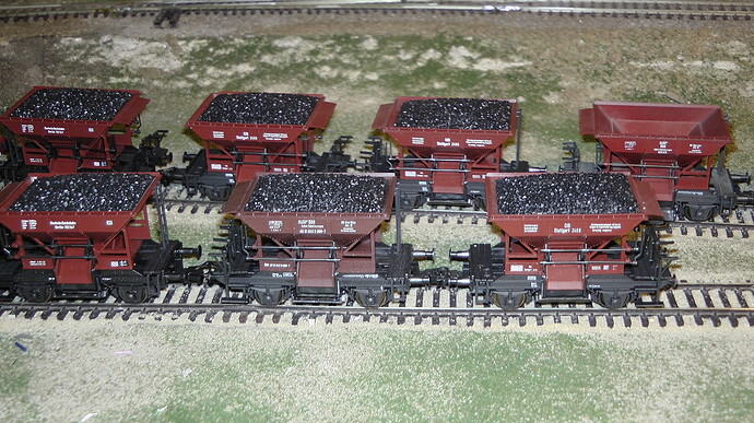

here is Hornby OO scale
this is a Roco Euro wagon
