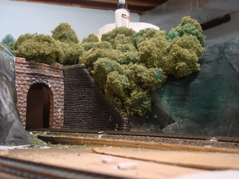

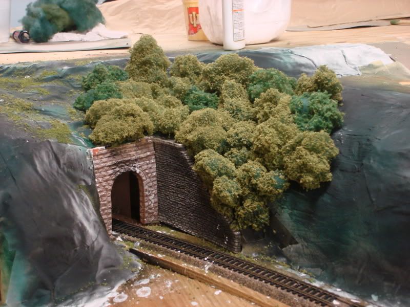

I’m working toward foresting a hillside with puffball trees (polyfiber balls coated with hairspray and rolled in a container of coarse ground foam). The general effect I’m seeking is there, but just this one small area (it’s not much more than a square foot) consumed an entire small bag of Woodland Scenics coarse ground foam.
The intent was to do the hillside on the quick and relatively cheap, but at this rate of foam consumption I’m going to bust my meager hobby budget! Is there some obvious step that I’ve overlooked that would stretch my foam supply further?
BTW, there’s a few “trees” in there that were done with an old bag of extra coarse turf - it didn’t adhere nearly as well to the polyfiber and doesn’t look nearly as good.
All input/suggestions would be most welcome.

I think what’s using up the ground foam so fast is ‘rolling’ the puffballs in them. What I might suggest–and what I’ve done for a thick forested look is to tear the polyfiber and place them where you want on the layout, using whatever scenic cement you want to place them, and then sprinkling them instead of rolling them with the ground foam after spraying them. Then use another coat of hairspray to ‘fix’ the foam. You’ll find that you won’t be using as much ground foam and it will go a lot further with the same effect.
BTW, that looks GOOD! I don’t know what mixtures you’re using,but you also might want to think of mixing in just a little bit of either yellow or dull orange for color highlights, depending on which season you’re modeling.

Other than the fact that I would have put visible trunks on ALL the foreground trees and a few in the second row, I think that looks very good. Just go back over the spots that didn’t adhere well and use something a little stronger than hairspray: 3M spray adhesive, maybe?
Personally, I like this method of making forests (I use a big block of foam painted green to give height to the middle of mine, surrounded by 1-2 rows of hand made trees). I think it’s only “cheap” compared to using pre-made, store-bought trees (lots of $$), or making them yourself (lots of time). Those of us who model areas with lots of trees (like New England) are doomed to spend lots of money and time on forests.
Yeah, good point about the rolling – didn’t think about that. I spray and sprinkle after it’s on the layout myself. That way you only use ground foam on the parts you see, not the whole “tree”.
DUDE! Looks great!

Looks great so far, except the bare spots. Maybe a spray of your favorite stuff, (wet white glue, hair spray, clear spray paint) and sprinkle a little fill in the bare spots?

I would switch to finer ground foam. The coarse won’t cover as much simply because it’s bigger, so there’s less “pieces” in the package. I use Scenic Express fine foliage, I get it in the large shaker, and it lasts seemingly forever.

The other trick is to combine more detailed trees in the foreground so the eye “believes” that the puffballs are actually trees.

The suggestion to use fine ground foam is not the proper texture for most deciduous trees in HO (unless the leaves are very small), as I discuss in my Scenery Forum Clinic (read my post on texture). Your puffball trees done using coarse ground foam look very good, but there are some ways to not spend so much money on ground foam. Fine ground foam should be used on conifers, but coarse ground foam is more correct for broadleaf deciduous trees.
