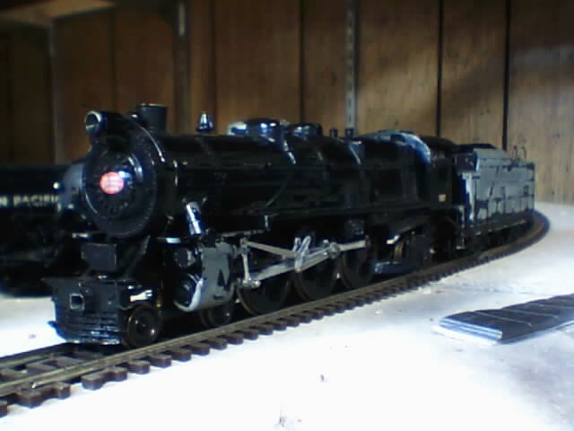

just got it re-assembled, it had no tender connector, I had some extra connections laying around excactly for this issue, some extra Bowser screws handy, hooked engine tender together, already lubed out.
This engine won’t quit now. No it doesn’t need the weights sitting on the right, its plenty heavy.
Previous owner put an NYC emblem on the smokebox, dunno if NYC ran these.
Dead engine yesterday, shining perfection today…
K4’s are all PRR, all the way. Piffle on putting a NYC emblem on one.

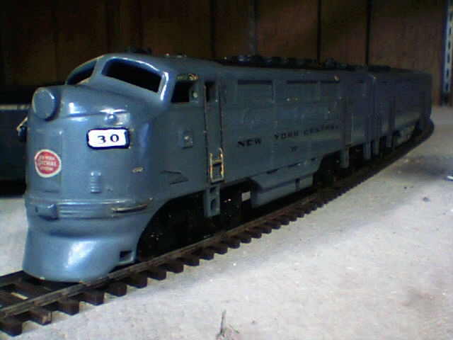

The Varney F3 turned into a bigger problem child than expected. First the motor is solid mounted to the body, but it has a belt drive, this puts forces on the truck forcing it upward angling it. Cant do that number 1.
2nd it has this large flywheel. The motor freespins on it someohow. I figured out this is a flywheel coasting drive. At first I couldn’t remove it but taking it all apart I put it in a vise, small tool on the shaft and lightly pounded the flywheel off. With pliers I could grip the pulley and turn the flywheel, so I did looking at the flywheel it looked like it had a separation like it could separate, I turned and turned and it came apart.
Inside was a curious device. A circular deep double flange and in the middle was 2 rubberized tabs that looped around inside the flange. They were connected on one end with a small wire then the rest could pivot out curving around the flange. Centrifugal force when the motor ran forced these out and contacted the inside of the flywheel cavity, thus making it turn then driving the loco. These rubber thingies were ineffective, prolly due to age.
It goes to the curiousity box. Then I scrambled around all my gears and found some. I removed the motor mount and found the motor could attach directly to the truck just like their other drives. The SW is this way. Apparently the Flywheel Coasting drive is a mod from their normal stuff. Tinkering I found 2 gears that meshed together and put them on the motor and the drive shafts. (Removed the pulley stuff).
Trials and errors and a washer added to the rear of the motor to tilt it down to mesh better, it ran. Added a wire from the non-motor truck to the frame secured power contact and it runs perfect now.
dropped the dummy B unit behind it. All metal again plenty of power.
Now all 3 dead engines work. Its getting couplers fixed and taking care of the cars which isnt a biggee, and some paint som
