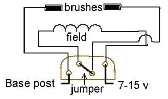

Separate the tender from the engine by disconnecting the wiring harness.
From there, you have to jumper the motor tabs and if the motor is in good working order, you will be able to run the engine without the tender.
Here is a link to the jumper setup.
http://www.trainweb.org/s-trains/diagram/jumper.gif
