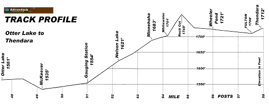

Our profile is far from flat - there are grades approaching (or surpassing) 1%. I like to point out the “Camel’s Hump” to riders on the return part of our trip - it looks amazingly like the scene in Polar Express when the train is about to crest a hill and go on a very steep downhill ride.
That said, there are times when I will see the engineer do a trainline reduction, but bail off the independent. I can only assume at this point that the the object there is to keep the slack out of the locomotive/consist coupling.
