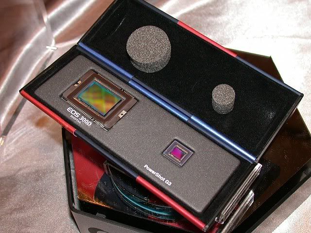

Short answer - the small sensor leads to a shorter focal length which leads to more DoF with a given aperture setting (than, say, a camera using 35mm film).

(I’m under the impression that the costlier digital SLRs have larger sensors than the point-and-shoots, which would require a smaller aperture, all other things held equal. Of course, they’re also more controllable than, say, my HP R607 point-and-shoot, which is really more of a point-and-pray camera. Any machine, sufficiently automated, approaches the limit of a random-result generator. But at any rate, though it can give art photographers problems when they want to do Cool Stuff, the digicams have been a major boon to us modelers.)

And here is a shot that shows the relative size of camera sensors. The large one on the left is from a Canon Rebel, the one on the right is from a Canon Powershot G8. Both are 6MP sensors, the DSLR one is many times the size of the point and shoot model. This is one reason why many choose DSLRs - larger sensors, more and better info can be recorded.
