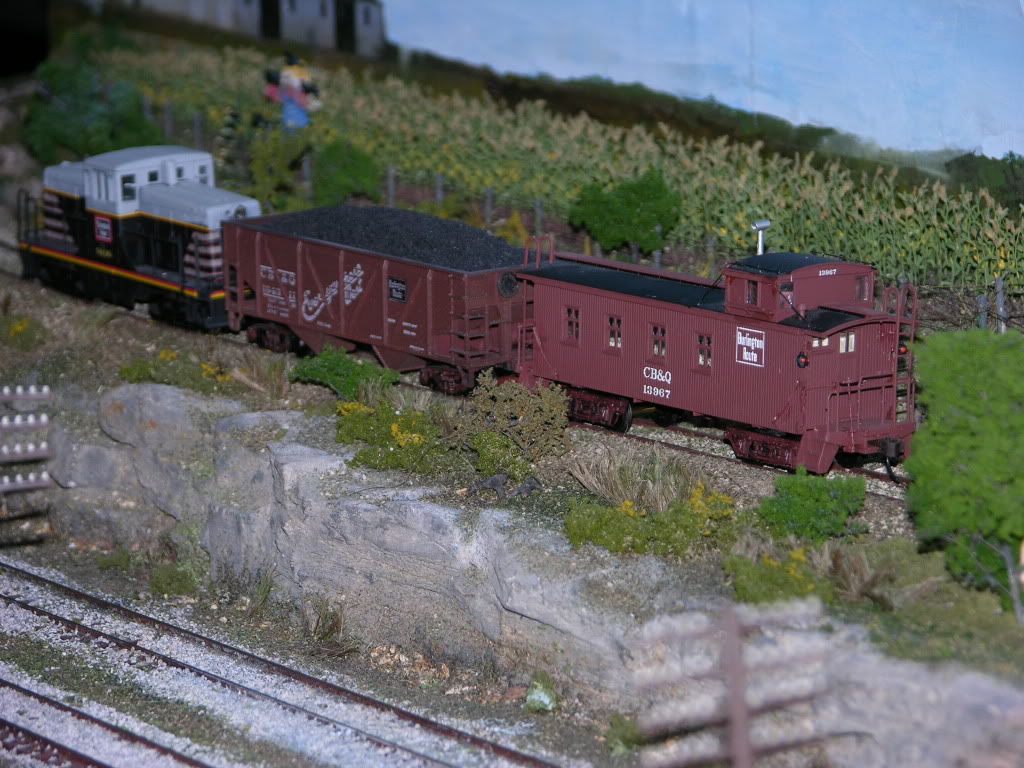

My Busch cornfield is part of a backgorund scene on a very narrow part of the layout.
It has been a while since I made it. As instructed by Busch, I painted the ears of corn yellow. Now I wonder why I did so becuase the corn would not have been husked while still on the cornstalk.
I used acrylic yellow paint, but I would leave the ears of corn green if I did this again. It is time consuming, and a full sized cornfield would take forever to put on the layout. I glued each little row to the layout and filled over the bases earth colored ground cover.
I included a scarecrow which was “kitbashed” from a Q-Tip. Crows sit on the scare crow and on nearby fence posts to be a bit humerous.
