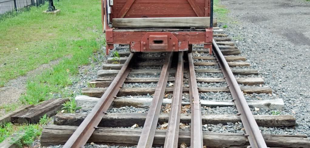

On page 292 of “American Narrow Gauge Railroads” by George W. Hilton there is a picture of three gauge track in the Cincinnati, Georgetown and Portsmouth’s Canal Street Yard. The rails accomodate equipment for gauges 5’ 2 1/2", 4’ 8 1/2" and 3’. There are four rails.
From left to right I’ll call them rails 1, 2, 3 and 4.
Rail #1 is for 4’ 8 1/2" equipment only.
Rail #2 is for the 3’ and 5’ 2 1/2" equipment.
Rail #3 is for the 3’ and 4’ 8 1/2" equipment.
Rail #4 is for the 5’ 2 1/2" equipment only.
I make that to be 83" (6’ 11") between the outer rails

We had triple gauge track in South Australia, 5 3", 4’ 81/2", 3’ 6" in a couple of places in the north of the state, there is a picture located here,
http://media.photobucket.com/image/triple%20gauge%20rail%20in%20South%20Australia/nineercharlie/Railroad/Gladstone_3_gauge_2.jpg

To my knowledge, and as several other folks indicated in their posts, several American steel mills had triple gauge track (the Homestead Pa. mill where I worked had some standard/narrow dual-gauge track in a section of its structural mill called the “Lower Beam”. We - the Union RR - spotted empty mill gons in this Lower Beam mill & pulled the loads using the standard gauge track, while the in-plant narrow gauge in this area was used by US Steel to move rolls to be put into the mills rolling “stands”.)
More specifically regarding triple-gauge track, I seem to recall seeing some in a picture in a 10- to 15-year old copy of Rails Northeast magazine. Shot was of Bethlehem Steel’s namesake mill in Bethlehem, Pa. The “middle” gauge was standard for gons & hoppers, etc., the narrow gauge was used for roll movements similar to Homestead’s discussed above, and the wide gauge was electrified (high 3rd rail, I think) & used by Bethlehem to shuttle iron ore along the edge of one/some of their ore storage “piles” next to their blast furnaces.
Hope this helps…urrSam

Triple gauge, yes. There was some triple gauge track in Pennsylvania between Carbondale and Scranton. The three gauges were: the D&H gravity railroad at 4’3"; The D&H standard gauge main ; and the Erie’s 6’0" gauge track. For reference, there is a picture on page 62 of Jim Shaughnessy’s book on the Delaware and Hudson.
