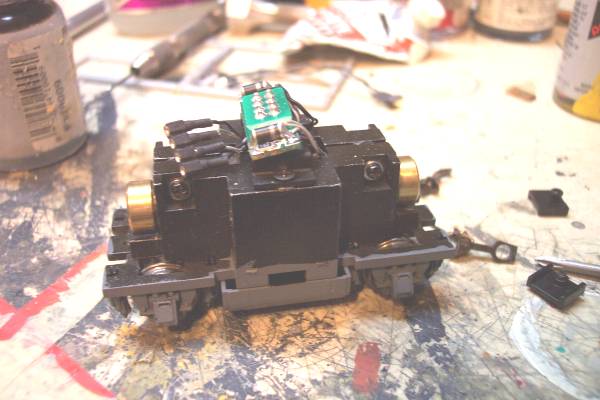

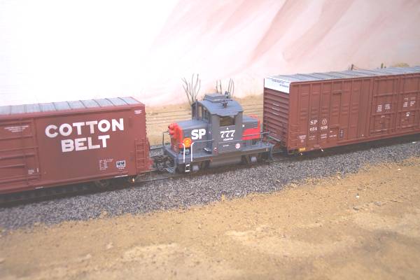

here are some more shots of my SP critter… and a shot of the guts.
you can see the circuit board on top. the 4 pin black plug is for the LED lights. it also had a plug for a DCC decoder. my critter runs fine. no surging or anything. I would try running yours with a different power pack and see what happens.
