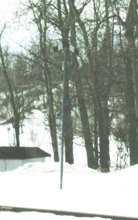

This one looks like an odometer set at “0”.

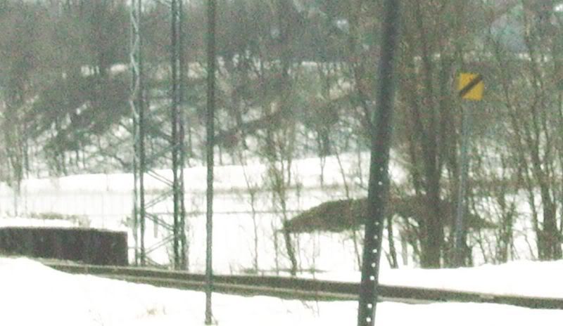

The sign below is a small orange square with a black bar diagonally (down to the left) across it. There is a pair of these, one for each direction, at opposite ends of a small bridge over a creek. You can see the bridge to the left of the photo; the sign is at the right.

The only one I’m certain about is the second - “Raise Flanger Blades.”
The flanger blades are small auxiliary blades on a snow plow which ride just inside and below the railheads to clear ice and (small) debris that might lift a flange over the rail. I’m sure that bridge has guard rails. Flanger blade vs guardrail is a lose-lose situation, hence the sign.
Other places where they would appear is approaching grade crossings, specialwork or any place where equipment (immovable permanent obstacles) might be found between the rails.

However, this railroad – the Charlevoix RR (a CN subsidiary) – has several of grade-crossings and small bridges (some of which are larger than the one in the photo) along the stretch near my house just east of Quebec City (Canada), yet this is the only instance where I’ve seen such a sign.

BTW a snow plow (though not a rotary type) could have flanges, but usually it was a separate piece of equipment called a “flanger”. The flanger sometimes would be all that was needed to clear snow, other times it would come in after the snowplow to clean up the area around the rails on either side.

The sign in your first picture may be “Mile 00.0”, the beginning point for subsequent mileage posts on the subdivision. My guess is that that chevron-shaped signs are a warning to “retract wing blades”, while the lozenge-shaped sign with it is for “lift flanger blade”
