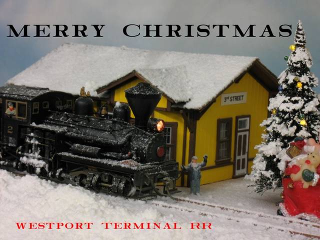

This is a temporary removeable Christmas scene on the 4x8 “plywood central”. It’s made of layers of that terrrible pellet type white 3/4" stuff - used it because of color. The buildings, trees, and some of the other stuff is the Christmas Village type stuff, trains & most of the figs are regular HO. This was put together with the help of my grandson John [:)] The foam was cut out with a hot knife, glued to gether with white Elmer’s, and the edges smothed by useing a Bernzamatic torch (in the detached garage - don’t ever do this in the house!!) The neat part is that I pick it up after the holidays & the foam is ready for next year! This is the previous year’s set-up.
MERRY CHRISTMAS!!
(ONLY THREE MONTHS EARLY)
