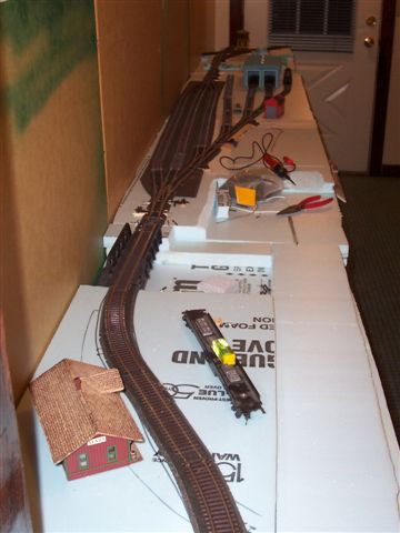

As per your request, here are the pictures of how my modules hook together.

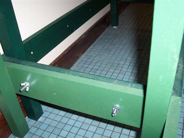

This photo shows the bottom two bolts which hold the lower end together. You can also just make out the little leveling feet under each leg.

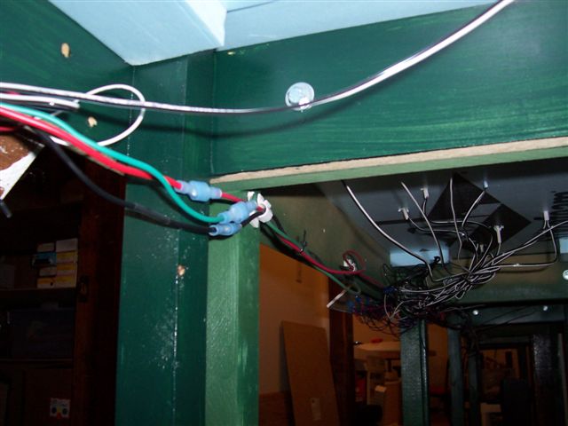

Here is the underside with the top two bolts and my wiring connections. I use three wires which run the length of the layout to control the block wiring.

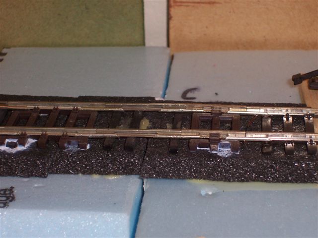

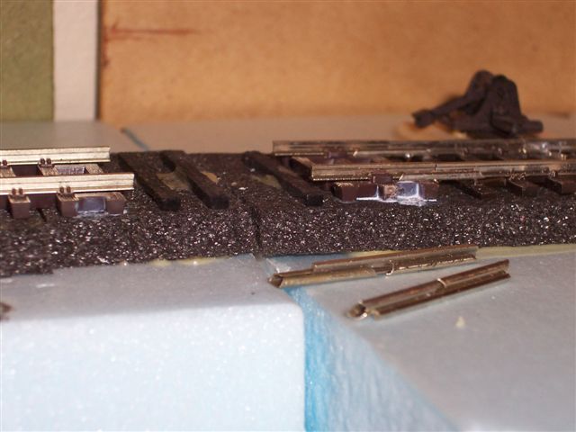

Once the two connecting modules are level, I am ready to place the two rails. Each rail is one inch long. This one inch bridge is common on any module junction.
Here they are in place.
These four modules are for the MP interchange and yard.
The track work is done and now it is time for scenery!
I hope this helps you out. Let me know if I can be of further assistance.
