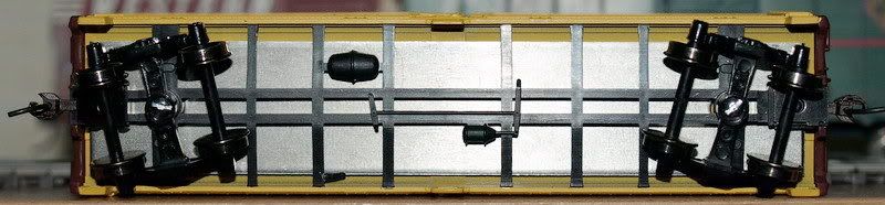

I’ve just re-adjusted the point where you can see in the pictures on the coupler, the truck has no problem and it’s flexible.

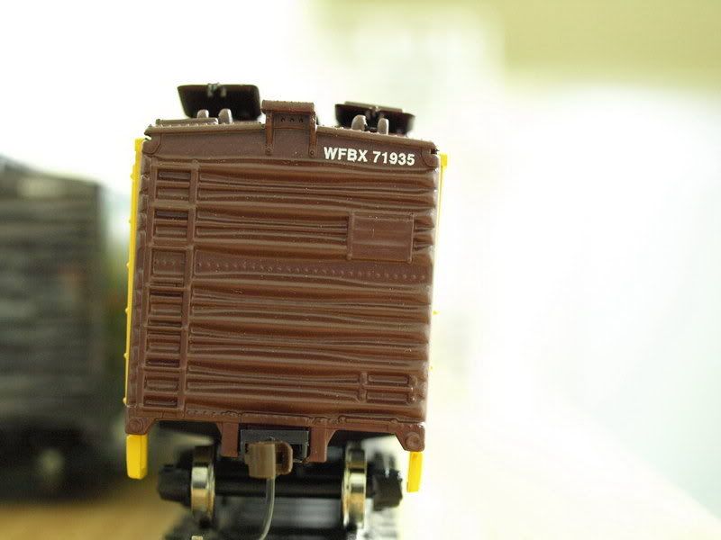

That car in the photo looks like it’s sitting off center slightly. The truck should be centered on the bolster and tightened down so that the truck can rock slightly, not a lot.

If there is no bolste rfor the car, you may want to get some washers, or scrap plastic, and make something for the truck to sit on.

Looking at the pic you posted, I’m not sure the body is sitting level on the frame. It looks as if the piece on the left of the pic shows more than the angled piece on the right. If nothing else shows up, check that.

I only moved a metal to the left, placed it on the track again. Then it works, the body is now sitting perfectly. with any angle just fine.
Actually, it’s not suppost to be like that. The metal should be centered.

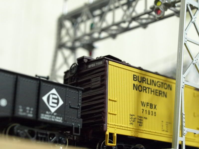

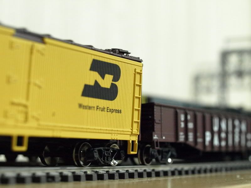

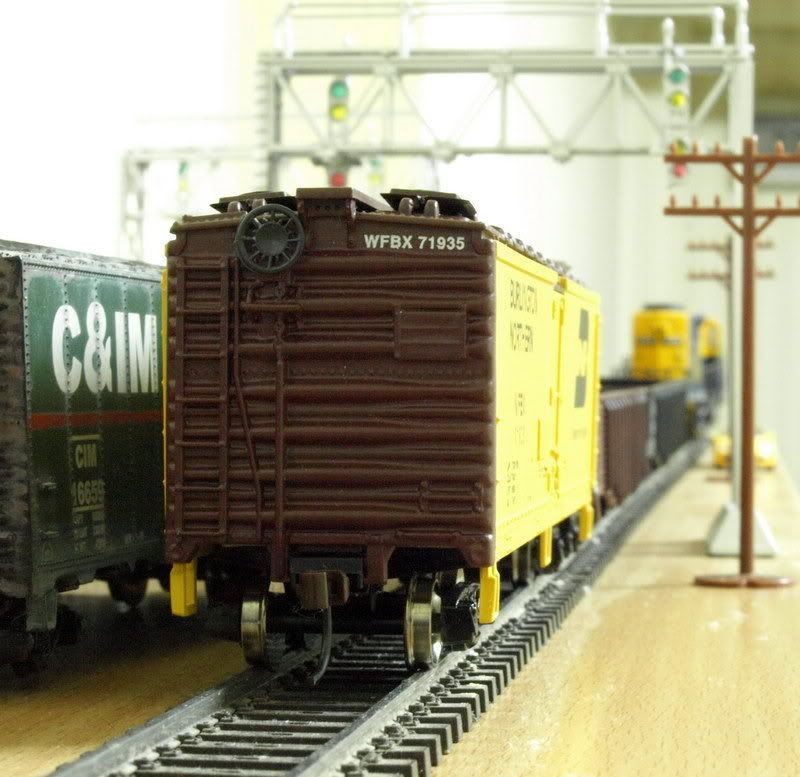

Now take a look at latest pictures.
