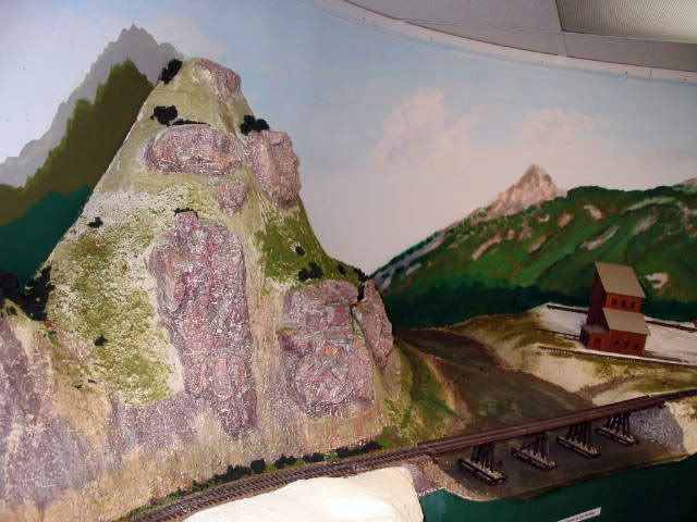

GREAT mountain pics guys! I’ll have to try that tin foil method. I’ve been using thinned down craft paint so it matches my home made foam. I haven’t tried applying it when the stuff is still wet though. I’ll have to give that a shot today. I find it’s still workable the next day and takes about 2 days to fully dry. Maybe I’m using too much water. I like the fact that it doesn’t crack off in chunks like plaster does. Never tried it in rock molds either.
thanks for the DB site info, looks like a great source
Nah, mine takes 2 days, sometimes 3 in the winter, to dry as well! Also depends on how thick I build it! Good luck…taking the camera down into the train room now, so I will get some pics
Brian
