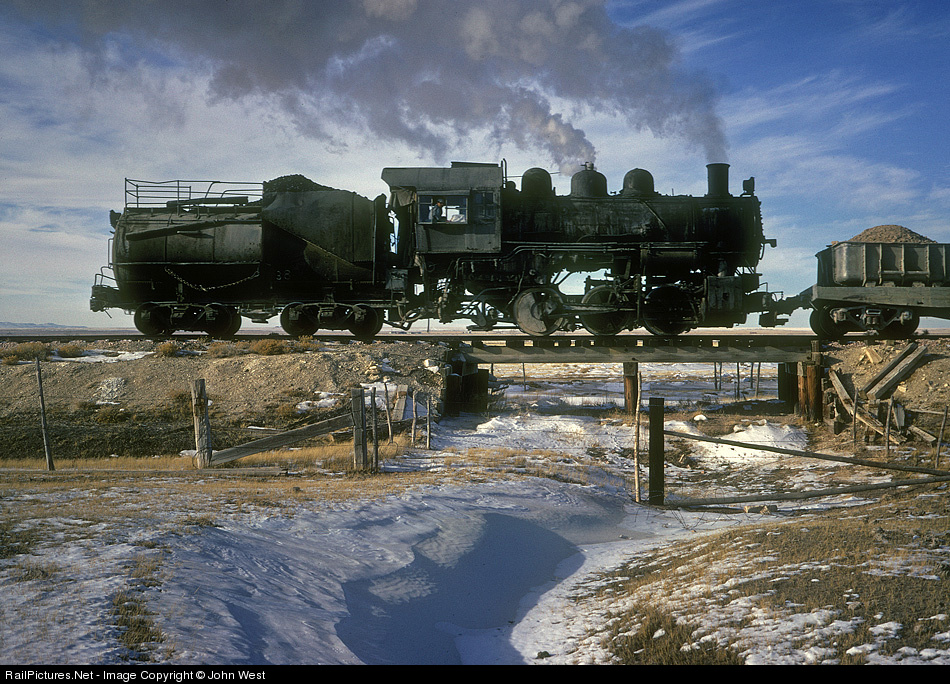

It is your choice. The UP #4455 worked the Denver Union Terminal in the late 1930s and 1940s. The Laramie Valley Railway, a Monolith Portland Cement Company subsidiary, bought it in 1949 and donated it together with UP to the Colorado Railroad Museum in 1972.
Here is a photo of UP 4455 at Laramie Valley Ry in 1961: http://www.railpictures.net/showimage.php?id=217507&key=4004838
